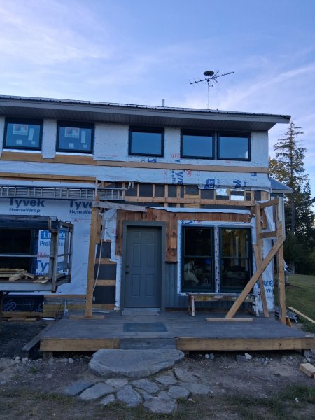

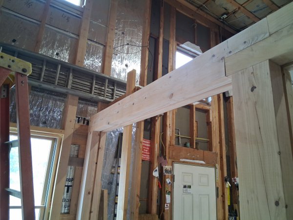

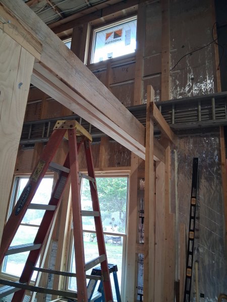

    The last bit of beam with the last post!

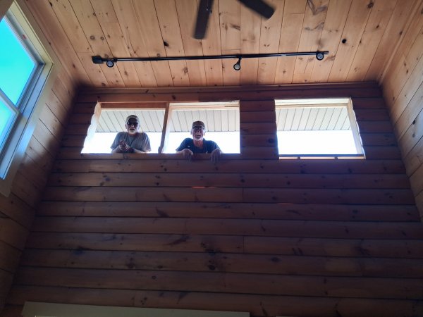

    11 windows and associated framing in.
    My brother and cousin pitching in.
    The original build was the right 14' of this pic. There was a reverse gable covering it and it was screened in. We've added 14' to the immediate left. It cost me a "bay" in/from the garage but it's a far better solution than what we've thought that we wanted to build. Not to mention saving a ton of money and time!
    Just those 11 windows were over $6600 and they're just decent Andersen 400 series! :headbang:
    That wasn't retail either. The 6 top windows are awning style. I had to keep them high and short to allow a decent pitch on the 30' wide porch roof under them. Having that daylight coming in to the house is fantastic. In the winter the sun rises directly in front of them and will shine (for a little while) all the way to the back wall!
    We're getting rain today after the 6th driest summer ever. :yes:

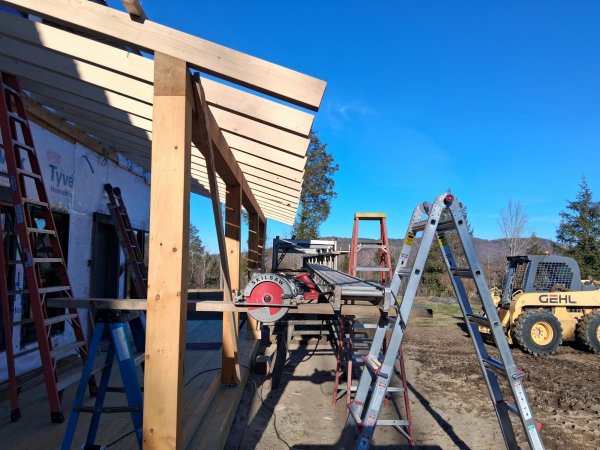

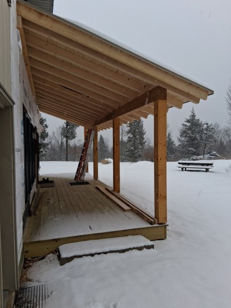

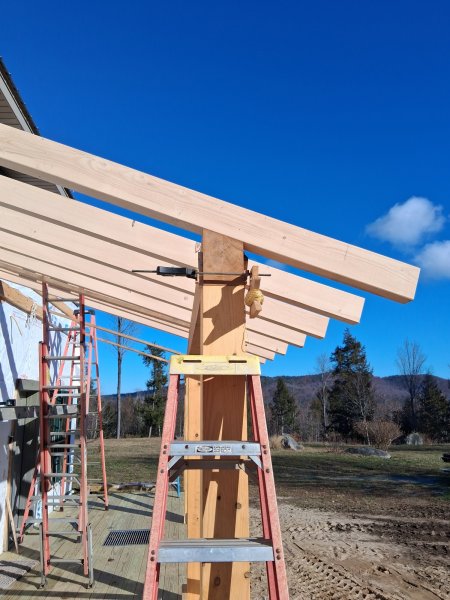

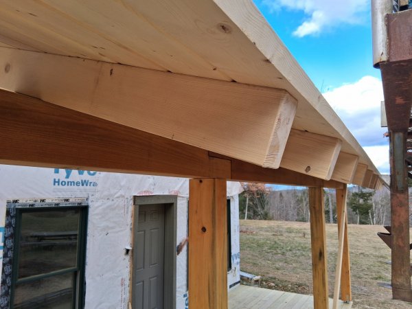

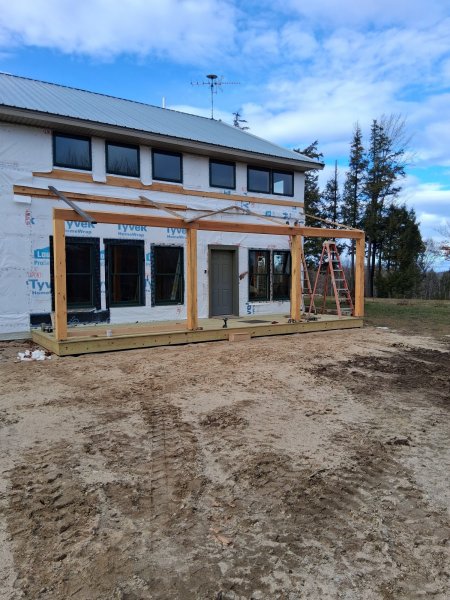

    A little catch up. My knees are burning from yesterday's climbing setting those rafters. 31/2"×6"× 11 long.
    I'm happy with the way it's coming together.

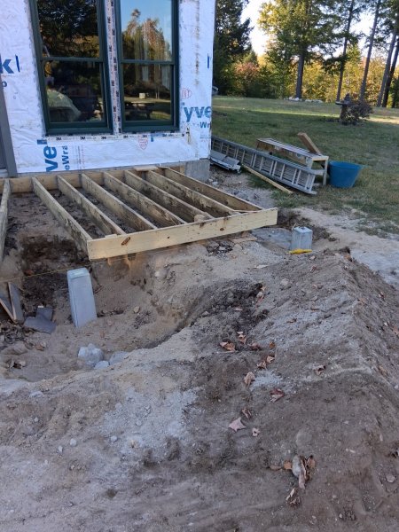

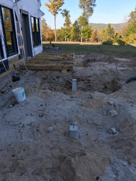

    The saved portion of the old entry porch. New proper concrete posts, the PT posts from the original were a mess after 16 years. Even being under roof!
    The deck
    Beam and posts.
    Both the ledger and beam is cut at the 4/12 pitch of the roof. I didn't feel like cutting the "birds mouth" with the rafters being 3 1/2" thick.

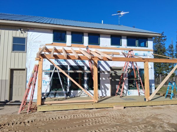

    Yesterday's work
    and that was after I sawed out, sanded and cut the angle and length on the 16 rafters.

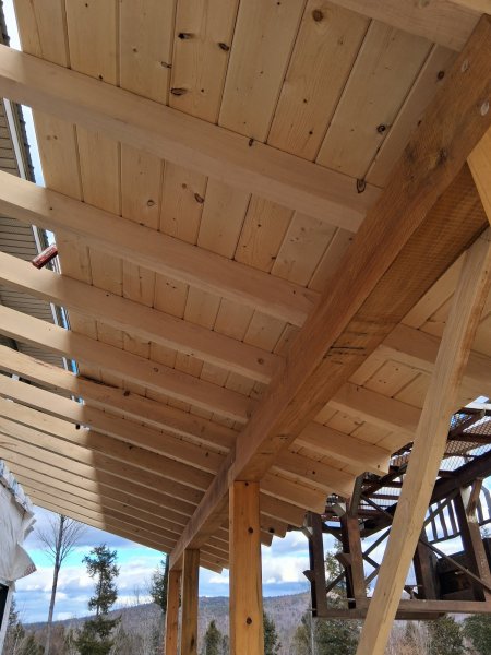

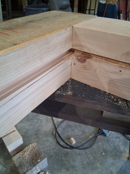

    Very nice work. Love where you joined the beams! Projects like this bring a lot of satisfaction!:thumbs:

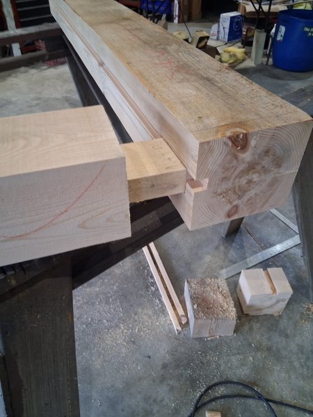

    I try, but don't look too close :whistle:
    Thanks :thumbs:
  8. Eric Wanderweg
    8,692
    69,083
    That’s what caught my gaze too. Something about half lap joints that is just… satisfactory.

    I always thought that the birds mouth was required to keep the forces going straight down.
  10. fuelrod
    fuelrod
    Oct 4, 2014
    3,508
    20,534
    Western Maine
    Na, it just creates a comfortable seat requiring little effort from your fasteners.
    At this 4/12 pitch the small "shear" forces are minimal. Now a 12/12 similar (non birdsmouth) connection would require a much bigger cross section of multiple fasteners or plates to handle the increased shear forces on the connecting fasteners.
    Either way the load path is vertical and a birdsmouth is just a joinery choice.
    In my situation I wanted as long of an overhang past the beam to keep the weather off of the posts and deck. Mainly the snow that can get pretty crazy when it slides off.
    With only 6" tall *rafters , a birds mouth would have removed too much material and possibly compromise the "tails" during the dramatic snow sliding off events.
    Remember there's another much larger roof above this little 8' deep porch. 20251119_134657.jpg
    *6" deep rafters due to clearance to the bottom of the new windows under the soffit. I'll have about 14" to properly flash and seal the windows. This window condition can be a problem especially in the winter if there's ice damming and the higher above the roof the windows are, the better. Fortunately that upper overhang above the 6 new (awning) windows is about 28".
    You can see how a conventional birdsmouth would have highly compromised the 6 x 3 1/2" rafters.
    I have had and worked on many of houses where they only left 4-6" of vertical distance between the porch roof and the 2nd story windows. Water is going to get in something and eventually cause major rebuilding. It's usually too late for simple caulking/flasing corrections by the time it's noticed.

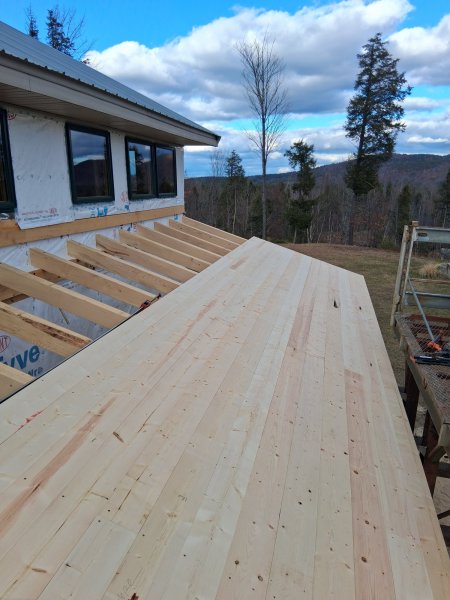

    The drop from the upper roof onto the new porch roof is a concern.
    My "red line" plans:whistle: got switched to rafters 2' oc from 3'.
    It's not much of a drop off of the upper roof, about 5'.
    I'm really liking the look and the proportions and what I'm looking for.
    I let the roof t&g boards run wild. I'll be trimming them down to around 14" for a little gable overhang.

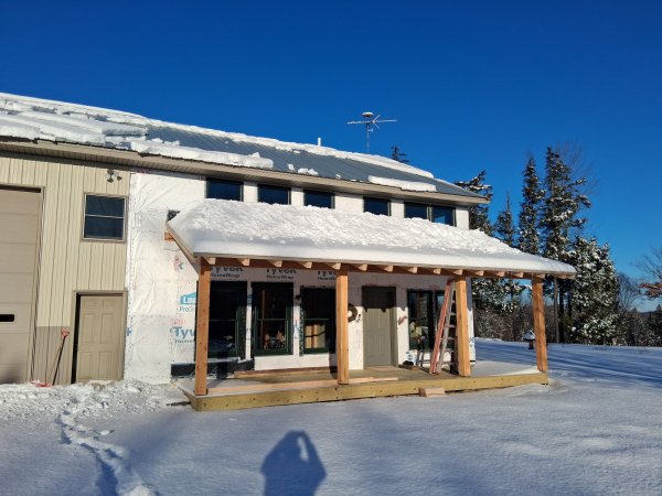

    Just in time before the snow!
    Actually a couple of days ago it got finished, ice & water shield and drip edge on. It's ready for winter or the metal roof. That material has been ordered.
    8-10" projected here before ending around midnight.

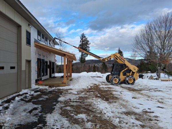

    Well I hope it slides with the metal (standing seam) roof on and the ice & waters minor texture is gripping the snow. My sawmill building is only a 3/12 pitch and will eventually shed the snow. 20251203_083246.jpg
    This only took a few minutes to pull the snow off but I really hope that the smooth metal will work.
    I know from years of removing the snow from in front of the garage doors after a 17' drop off of the roof it's compacted like a snowball and definitely not a job for a snow shovel and a tough job with spade!
    On the bright side, it falls nicely away from the porch with that long overhang.
