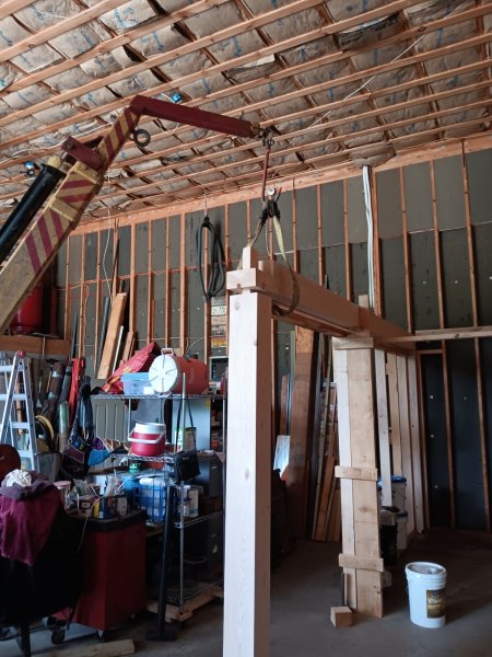

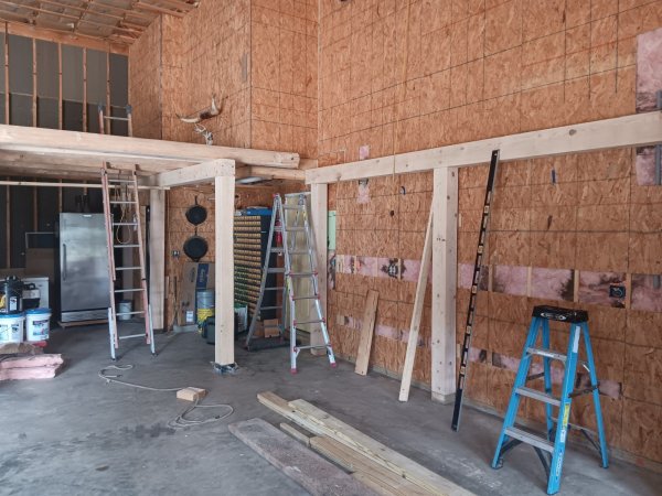

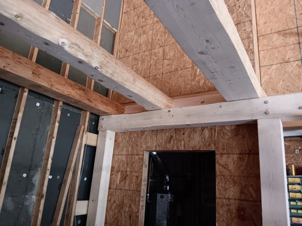

    It's really difficult to take a picture of progress at this stage.
    I'm stealing 14' out of my 64' shop for living space vs building an attached "barn like" great room. That was our plans for years but after drawing it out and actually thinking about the size, scope and cost of that, not to mention my wife's builder (me) is getting slow and a mornings work now takes a day. I don't want to spend the next couple of years on it!

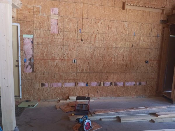

    That OSB wall is the existing house/shop wall. Our little place was really fine for the 2 of us, but Mrs. hasn't had a bathtub for 16 years and we'll have a proper spare room for when the kids visit.
    This will double our house size to 2200 s/f (+/-), I've never really done the math.

    Hey fuelrod your beams and posts look great! The mortise and tenon details are really nice. Love the big fry pans. When you are working on top of your beams, don't back into the steer horns! Could ruin your day.:bug:

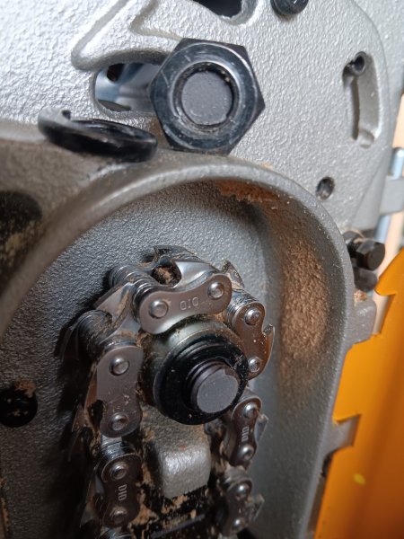

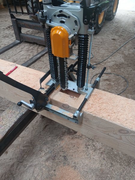

    My 5 week old Makita mortising machine has failed.
    It was a major tool "splurge" @ $62.50 a pound for the 44lb shipping weight! As luck will go I'm about 10 days out of the 30 that the seller gives for an exchange. :headbang: This morning I dropped it off at a Makita service center, luckily it's under an hour away in NH. Again as luck goes, the service guy is away next week on vacation but we got the part ordered today and it looks like an hour job according to the makita parts drawing.
    That's a short shaft off of a gear reduction that drives the chain sprocket. Must have been poor metallurgy, you can see both sides. One in the nut and the other in the sprocket. it snapped cleanly.
    Besides standing up the last frame, I need this tool right away for the next assembly.

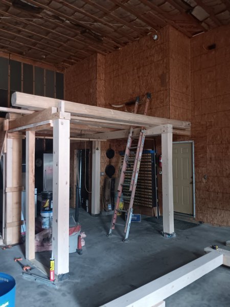

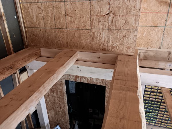

    The next "assembly" (actually just the floor system) goes against this wall. I opened up some areas for electrical work. The finished wall will be shiplapped pine on that osb in-between the posts/beams.
    This was a tight fit.
    This carries more of the "live edge" floor joists spaced on 2'-4 1/2" centers. The new spare bedroom will be upstairs and will stop around the middle post. The actual floor is 2x8 t&g and serves as the finished ceiling from below.
    Right now we're planning on continuing the log joists to the front creating (with no floor) a sense of a ceiling or trellis at the floor height of 8'3". That'll leave the actual ceiling of the shop above at almost 17'.

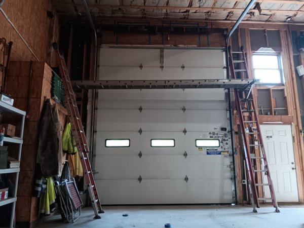

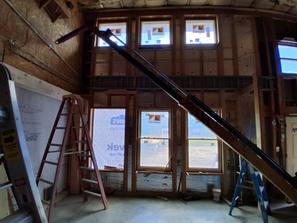

    I have a monster header that's over the 12x14' garage door on that front wall. It needs to go!
    That's where 3 windows are going.
    They need to be high enough to allow for a decent pitched porch roof. 20250524_153658.jpg
    It's a "paralam" 5 1/2 x 18" header about 12'6" long and very high in the air!

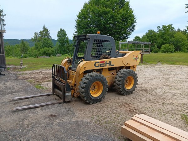

    I was starting to work on removing the OHD first, but decided (what should have been obvious) that frontal access with my Gehl friend to do the heavy lifting would be very handy.
    My Gehl friend :D

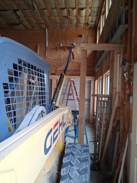

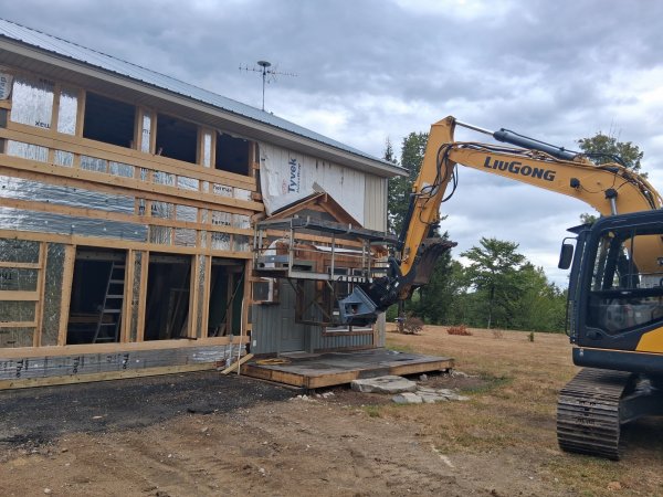

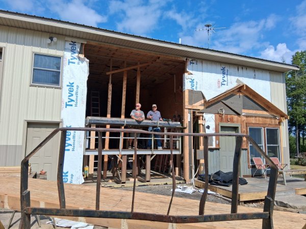

    Old porch roof (outline on the right) is gone, so is the massive garage door header and the 12x14 door. That 5.5" x 18.25" header is on the forks in this picture.
    ce41f6bb-cb5d-4731-874e-d2a1f5c2d056.jpg this is how I sawed the ledgers for the new porch roof to a 4/12 pitch. 39077f25-e5ba-4bfc-8ac1-c871bfd8504d.jpg
    The porch rafters will be "timbery" ie; 4x6" on 3' centers.... I think.
    The new wall will windows framed up with the first layer of rigid foam insulation and purlins and porch rafters ledger installed. I'm starting on the right side tomorrow.
    My Gehl friend is making this possible and Mrs fuelrod is getting good guiding the timbers into place running a tag line.
    That completes the post/beams along the house wall.
