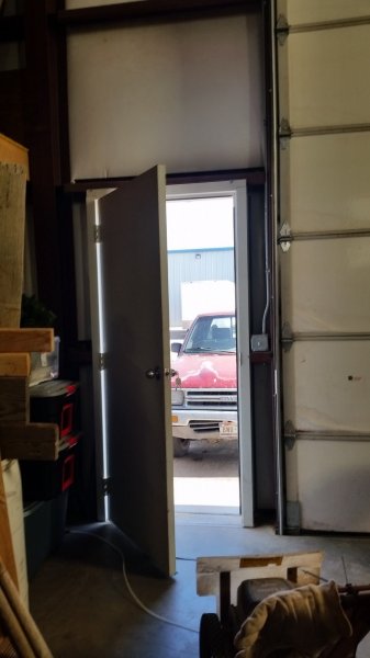

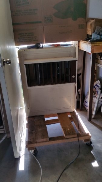

    I have a large swamp cooler for the shop, it's on a cart so I just open an entry door and it sets in the opening. With all the rain this spring the humidity starts off around 55 % and drops as the day gets hotter. This isn't helping at all with the shop temps,:hair:

    Sorry about that but in your area, you have to suck it up for the next several months. I never thought the swamp coolers would do much in a shop. They can do pretty well in smaller places but as with everything, there are limits.

    I understand, sorry for you! I had swamp coolers for 30 years now, worked great most of the time. Once it got above 30-40% humidity, they did not work that great. In a jam I have used the squirrel cage only, atleast for a breeze. You mentioned you opened the door, maybe try an exit for the air on the other side of the shop might help.

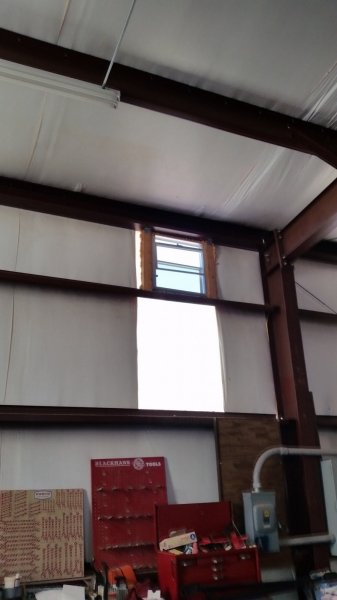

    I have a high window that stays open and the other entry door opened, swamp cooler only adds humidity, I can usually knock 5 degrees off the shop temp but not while the sun is up now.
