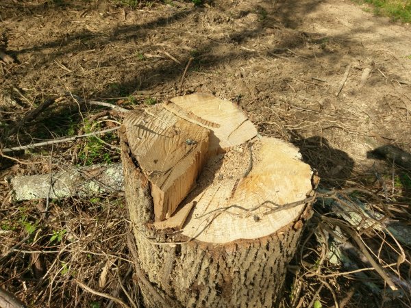

    This was going to be my advice...a fat hinge...at least 1" if not more on 20". Using a bore cut to set the hinge, leaving a strap on the backside to finish off should help to reduce barberchair possibility. This is about a 16" stump. I used this method mainly due to a hard forward lean. I got too close to the hinge in the foreground on this one, but there was plenty of meat on the far side. I hope this illustrates the cut for you. Cut wedge, then plunge and set hinge, cut outwards towards back of tree leaving holding wood, then come from the back side in to release (step up on finishing cut just slightly). *note* I am by no means a professional. I have used this cut a decent amount and it has worked great for me thusfar. The pic below is not a 'textbook' cut, but it got the tree safely on the ground. lol
