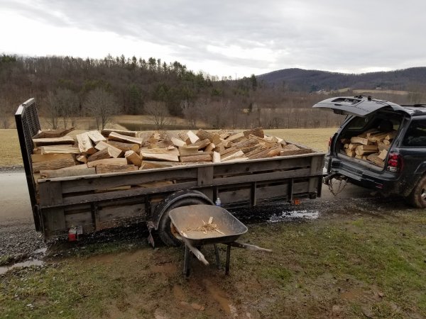

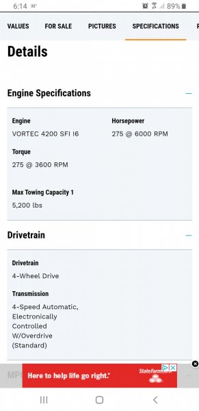

    Towing capacity for my truck... Screenshot_20200128-061421_Chrome.jpg Trailer weighs about 1500... 20180228_133150.jpg Was I a bit over? Yes, it was loaded right...Most weight on the tongue. It just looks wrong due to the road grade. The things we do for free firewood. Future scores like this will be 2 trips...Truck is getting tired. I just wanted to be done with this score already. All that is split there had to chucked up 12 basement steps out a bilco door, almost a cord. I had already made 2 trips full of rounds the day before, and this day I stuck the truck earlier.... 20180228_102259.jpg

    Seems a little conservative to me, but better safe than sorry I suppose.
