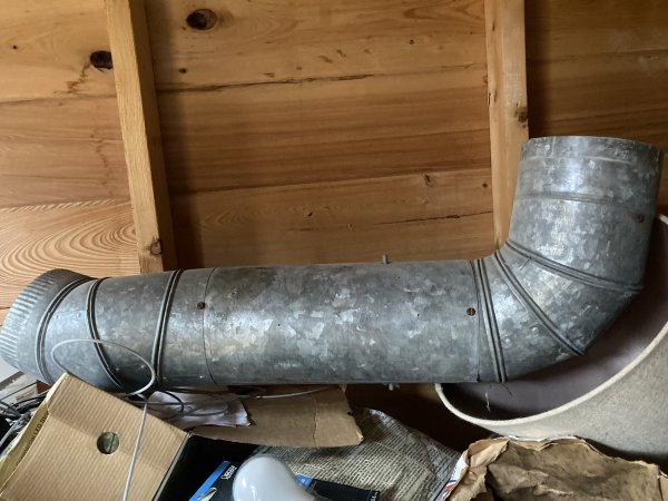

    I have a piece of galvanized? tube that I scavenged a discarded piece from an hvac. Hopefully it fits without too much effort. Also not sure how long it will last, but should give the stove some breathing room.

    A galvanized pipe heated hot enough will put off zinc oxide which is not good to breathe.
    I realize though that this is an outside install.
    Just something to consider.

    Good point, I’ll double check if it is galvanized or not.. maybe it is worth getting a rain cover of some sort too.

    Yeah, I think the one I have is galvanized based on that marbled look
  11. buZZsaw BRAD
    34,706
    214,592
    yup, thats galvanized.

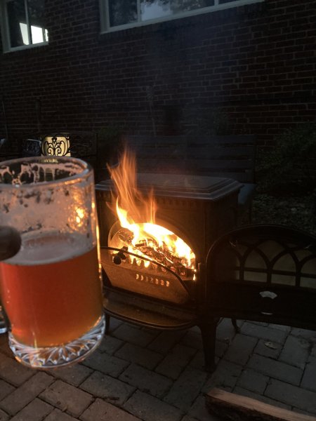

    I had to fire it up without a pipe.. it took a little while to get it going, but working well now.
    Does anyone know if the Jotul 3 is supposed to have a top baffle?
    home brewed beer using kveik yeast (Norwegian) and Jotul stove (Norwegian). I should go get some of the Norwegian maple.. it should be about dry by now.

    Looks inviting. I can feel the heat :coldfire:from here...must be black locust in there! :whistle:

    Close, as the wood pile is stacked... it is tulip poplar!
