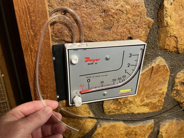

    One way to monitor draft is to use a manometer. I have read that my stove should run at . 06-.08 my pipe damper helps me maintain that window. The manual doesn't say anything about using a damper. In fact I don't think they had one in mind because the stove has a 1" diameter 5' long pipe running up the stove pipe that is vented to the back of the stove. Apparently this was some attempt to introduce secondary air and reduce creasote. There would not have been room to put a damper in with that running up the stovepipe. Btw it's an Earth stove. The PO cut it off so I am able to use a damper.

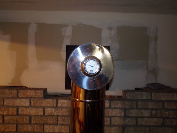

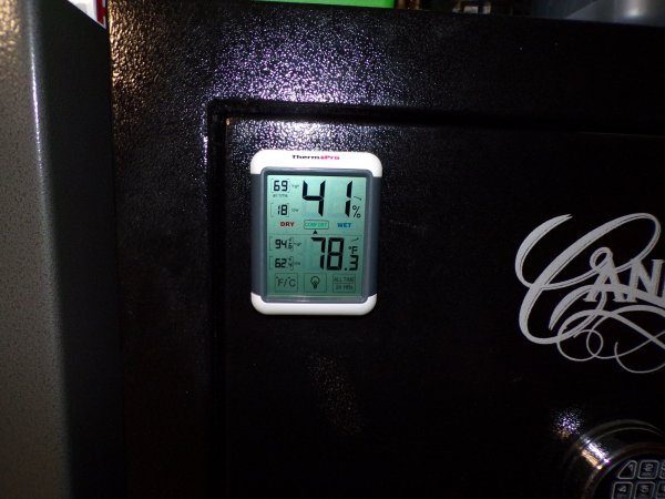

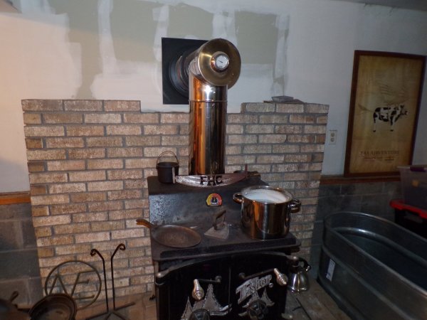

    Here ya go, just took these! You be the Judge. 2 oak splits in the stove, won't touch it till I go to bed! Room, 78º. Stove about 430º pipe about 325º. It will stay like that +- 50º No pipe Damper. When I cleaned this pipe out in the spring I got about a coffee can of soot/creasote. Walls are always shiney after a clean out. I never get any gooey sticky buildup. I have a 20ft run up to the cap. The cap does get cruddy because I got a bird screen on it and where it accumulates.
    You can see on the history it was 94º at one time... :eek::dennis:

    I like that stainless stove pipe and the two heavy boat anchors. ;)
    WeldrDave likes this.
  12. WeldrDave
    10,207
    56,309
    Where I'm at, if it were black wall, it would have rusted in less than a year. Stainless around here is the only way, but it's a bit pricey $$$
