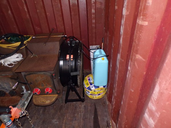

  18. WeldrDave
    10,207
    56,309
    Bring it on my Friend! ;) There's 3 of them ready to rock and roll! The Bicentenial, 76 edition will be in the main floor of the house and one of those Mama bears will be in the Basement! :cool::):stack::fire: We'll be quite toasty!
    Those Mama bears alone can heat up to 1500 sqft easily! :yes:
