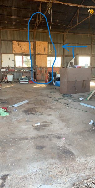

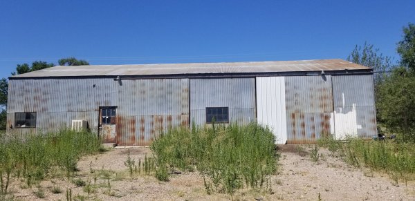

    Wall thimble install questions:
    I'll still looking at installing either my Fisher XL or Grandpa in my shop. It's a 1950's pipe built shop, metal sided and that's it.
    1. I think going through the wall is my best bet.
    2. Can I buy a wall thimble with 45 degree piping?
    3. How far up the outside wall does the cap need to be?
    4. Here's two old picture of where I'd like the new wall thimble to go.
    5. After looking at the picture, I could move it to the right centered on the wall. I guess cutting a hole in the roof is no big deal. Difficult for me to plan!
    6. There's a built in welded bench along 3/4's of the inside wall shown, all or part can be removed.
    7. I'm having some issue with my hip so meds and the office chair today, I'd have the stove close to the side wall and middle of the shop. Vintage 2"x6" 'are the only combustibles I see on the roof, would I have to go above the roof peak with the pipe?

  10. Hoytman
    Hoytman
    Dec 13, 2018
    1,254
    2,787
    OH
    2. They make these in 5”, 6”, 7”, 8” and if I’m not mistaken insulated and uninsulated.
    Ventis 6'' Class-A 30 Degree Wall Pass-Thru
    Can’t recall exact code…something like measuring from the top of cap 10ft over to the roof the cap would need to be 3ft above the facia in that picture photo. So 3ft above roof at facia and you can’t measure less than 10ft level horizontally to the roof.
    Those are minimum requirements. I’d go up 8ft-10ft above facia on a roof that large which greatly would extend your horizontal measurement to the roof to much more than the 10ft minimum horizontal measurement required.
    You have lots of down draft potential coming across the top of that roof at minimum measurements for that location.
    A centrally located (coming out the roof peak or just beside it and extending 3ft-6ft above it) stove and chimney is best. Especially for that big of a building. If it’s uninsulated you’re going to have a hard time heating that shop even with two Fisher’s burning full tilt. Locating any stove to middle of the building with double walled stove pipe is going to be the best way to distribute heat inside and you’re going to need double walled stove pipe to keep draft high and hot to prevent creosote build up inside the pipe.
    Next best stove location is middle inside wall as you mentioned, but it won’t do much for heat. In an uninsulated building with that much ceiling height I’m not sure moving the stove and chimney to the middle of the floor/building will help much either. If it’s uninsulated you’re going to need a fuel oil tank sized wood stove and a 100 acres of timber to feed it. LOL!
