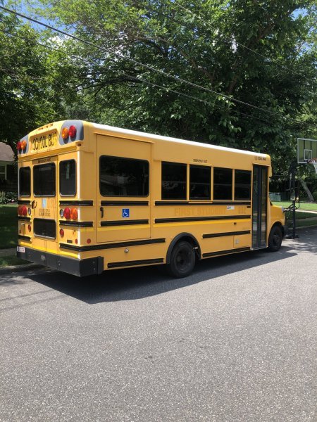

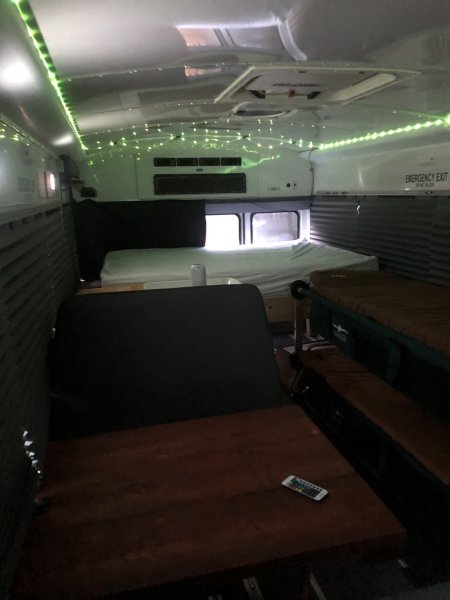

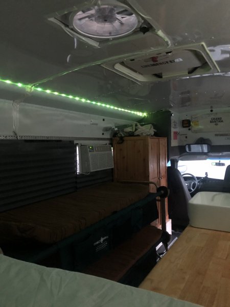

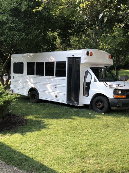

    Back in June I bought a 2010 Chevy Express 6 window school bus with the intention of turning it into a camping and hunting rig for the family. We got back from our first trip to Worthington State Forest in NJ earlier this week and it worked out great. Hunting season opens soon here so I will be taking it out on some trips this year.
    The "living space" is 120 sqft. It's powered by a 6.6l Duramax diesel (I'm getting really good mpg with this thing and I'm very happy w the range per tank). It has a rear emergency door as well as a side door where a wheelchair lift was. Both doors now open to storage under my queen size platform bed.

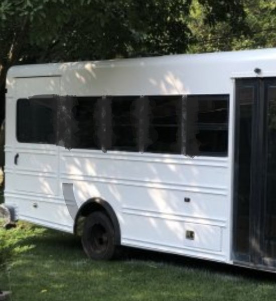

    I painted the bus with Rustoleum tractor paint from TS. Mixed it with mineral spirits and sprayed it with an airless sprayer from HF. Came out better than I was expecting. I laid down 2 coats of primer and 2 coats of white paint.

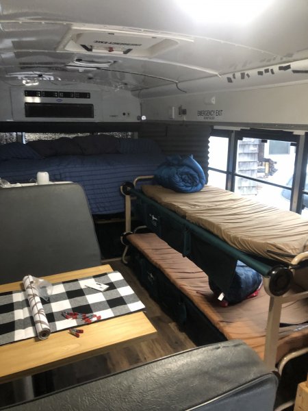

    I kept 2 bus seats and made a dinette area out of them. The seats have seatbelts so everyone is buckled in while the bus is moving. The dinette seats 4 comfortably.
    Behind the dinette is my "kitchen". I found a butcher block dining room table for sale on FB for $20 that was is rough shape. I sanded it down, cut it to fit and applied food grade mineral oil to the surface. It came over so nice I didnt want to cut a sink hole for it so I opted for a bathroom vessel sink instead lol. I just had to cut a 2" hole for the drain and another 1/2" hole for the water pump tube. The faucet is a USB powered water pump meant for water cooler jugs. We have a 5 gallon fresh water jug and a 5 gallon gray water jug that the sink drains into. I have a Coleman stove that I can use to cook indoors if I need to.
    Under the counter I have the 2 water jugs, an upright storage bin (food/snacks) and a 12v refrigerator.

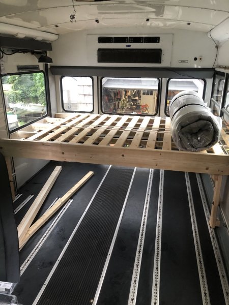

    Next to the kitchen is the raised queen bed and plenty of storage underneath. I keep a 8k btu window AC unit under there as well as a chinese diesel heater.
    Opposite of the kitchen is a set of disc-o-bunk cots for the kids. These are removable if extra space is needed to transport kayaks, etc.

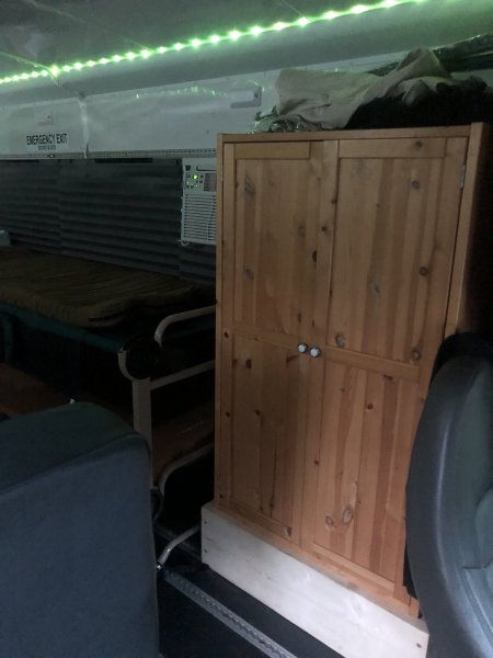

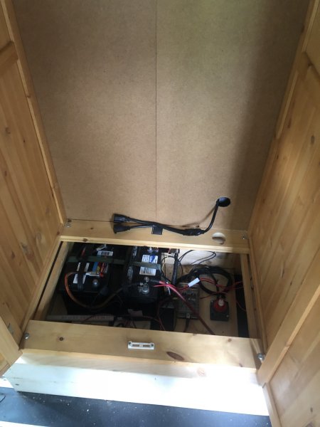

    Next to the bunks is a small armoire that was another FB find. I built a raised platform for it that houses all of the deep cycle batteries and electrical components. The bottom of the armoire comes out and I attached a handle to make an access panel. Inside the armoire we store blankets, tp, paper towels, a coffee maker, and there's plenty of room for jackets/coats.
    I used the hole that the bus' stop sign wires came through and installed a shore power port. That port takes a standard extension cord and it splits off into 2 receivers. One receiver is hooked up to a 12v battery tender and the other is hooked up to a power strip so I can run 120v when hooked up to shore power or our generator. It also powers the ever so important coffee maker lol.
    I power the window AC unit as well as the the shore power port with a 4250 dual fuel inverter generator that I run off of 20# propane tanks.

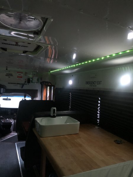

    For lighting I have a 32' LED rope light that's usb powered (only 5v power) as well as 4 LED battery operated dimmable lights on the walls and 2 roof mounted LED directional lights. Both from HF.
    I installed a Maxair fan in the roof. It's multi-directional and runs off the 12v batteries.

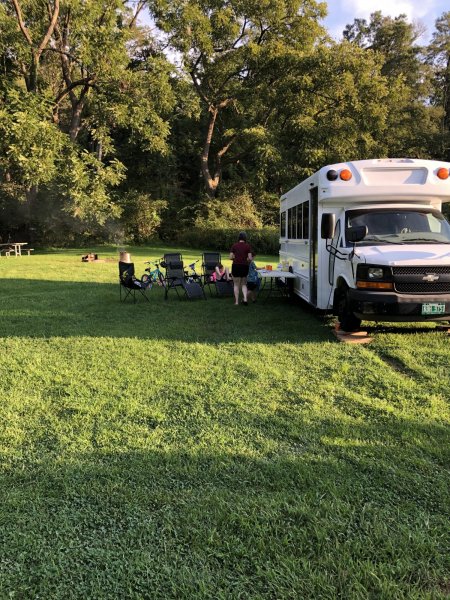

    Some pics from our trip to Worthington State Forest, NJ last weekend

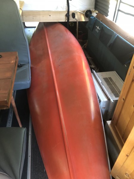

    Picked up an old 17’ canoe yesterday at a yard sale. My son and I had fun paddling around a small pond in the afternoon. It just fits in the bus.

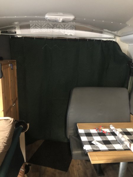

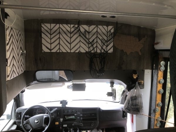

    Did some interior updating over the past week. Laminate floors, new table top, wall panels, privacy curtain and changed the area over the cab so it doesnt look like a school bus anymore.
    It's been a fun project.

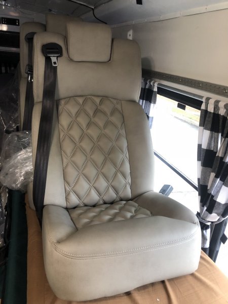

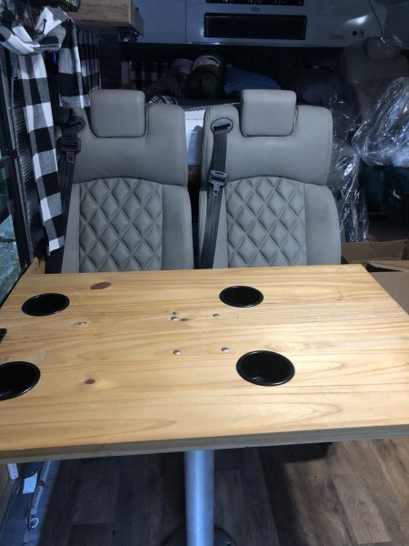

    Goodbye bus seats, hello leather executive style seats [​IMG]
    Found an amazing deal via FB marketplace. Brand new, still in box.
    Integrated seatbelt and adjustable back.
    2 installed, 2 more to go. I'm going to put one of the yet to be installed seats on a swivel so it'll be able to face forward and act as a front passenger seat.

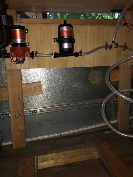

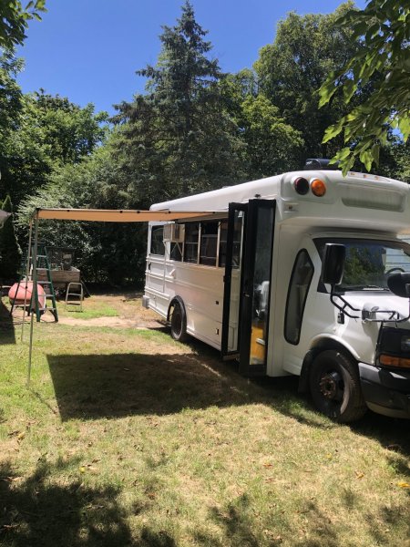

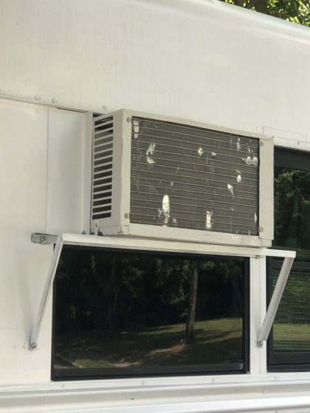

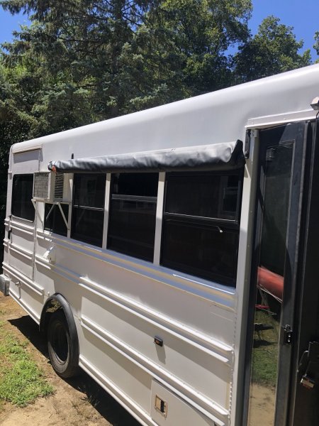

    Few more updates to the bus. The factory AC isnt working (has a leak) and can only be used while the bus is running. I mounted an 8k btu window unit out the side of the bus and run it from a generator via a 115v port I installed on the rear of the bus. It's nice driving in a cool bus.

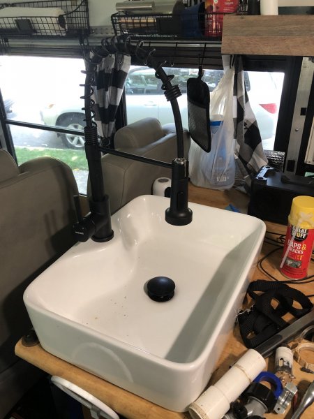

    I now have running water and hot water for dishes and an outdoor shower via a tankless propane water heater.

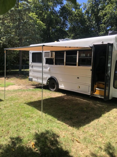

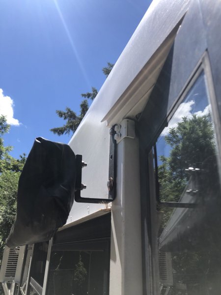

    Also installed an 8x8 awning that are used by a lot of overlanders. It's an ARB knockoff from Napa Auto and has great reviews. Only modification I had to do was turn the L bracket into a J shape. Installed each bracket via 2 riv-nuts into the frame of the bus. It's nice having a real awning instead of a tarp.

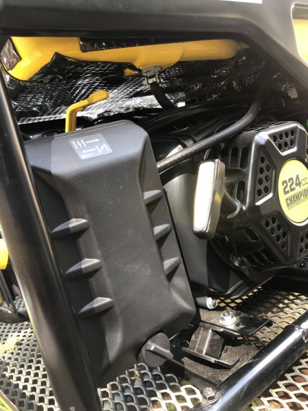

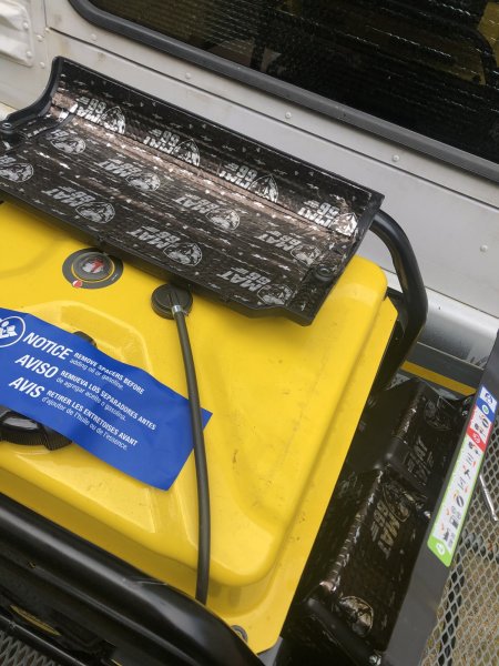

    My next project is to make my open frame inverter generator more quiet. I took off the plastic face panel and applied some kilmat to it. I also applied kilmat to the underside of the gas tank. I have some aluminum sheets that I plan on cutting to size, covering in kilmat and attaching them to the gen frame to enclose it similar to a honda eu2200 and alike. I know it wont be as quiet as one of those but if it can reduce the noise just a tad it'll be worth the effort.
