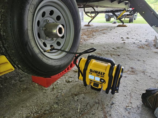

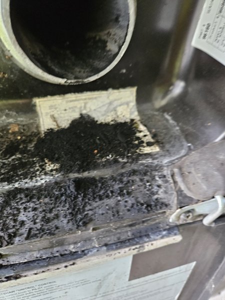

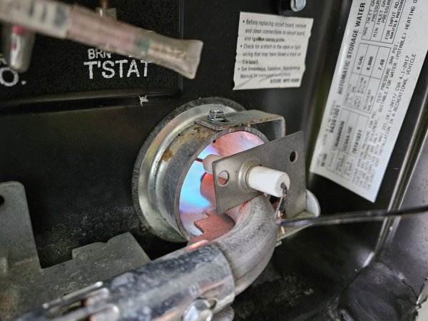

    Had time this afternoon to check into the water heater problem.
    Pulled the burner tube assembly and found the culprit...
    seems a mud dauber made a home.in there before we got it. 20240430_160558.jpg 20240430_160608.jpg
    Got the tube cleaned, then used a wire and some shop towels to swab the main tube several times. 20240430_161954.jpg
    SimonHS, wildwest, JD Guy and 9 others like this.

    Glad you got it figured out

    Mud Dauber on propane
    Wet wood both equal sooty mess … Got it T Jeff

    Given the amount of soot, it had been like that for awhile.
    The previous owner must have been able to clean the soot from the outside siding. I hope you are able to remove it.

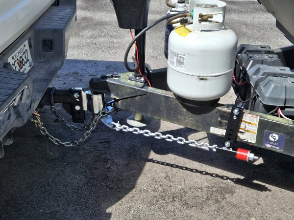

    I never really liked the Husky hitch that came with our camper, it had the 2" shank, so had to use adapter.
    I was very familiar with the Andersen hitch we have on the dump trailer, so we ordered another for the camper. Got it with the 2 1/2" shank, 2 5/16" ball, it's rated for about twice the camper weight...:thumbs:...
    Got it installed yesterday, pulled it probably 20 or so miles, very smooth, even at interstate speed.

    Looks good! I’ve always wondered about them hitches. What exactly does it do? I thought about one for when I had my 1/2 ton… but hopefully the 22ft camper won’t need it with the 3/4 ton….

    It does the same as a weight distribution and anti-sway hitch. Helps on the bounce too.
    We pulled the camper with a regular hitch the same place and speed as the new hitch. F250 did fine, just squatted it a bit. The thing is on interstates, when big rigs come by or areas with higher winds. Mainly just peace of mind.
