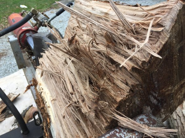

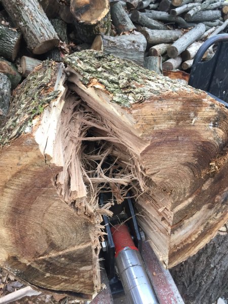

    So I have various splits of elm in this years wood. To confirm my previous 2 experiences with this species, I set a few aside so I could load the stove with nothing but. I did and low and behold at the bottom of my firebox is a friggin' mess. I open the door and shake the grates vigorously and see large block(s) that do not break up like normal ash. I had to use my poker to break them up to the size that would fall through to the ash pan. Removed the pan and took a vid to show you all what elm is like [for me]. And, it's consistent. Every time I've burnt the sh1t, this is what I get. I AM DONE. After it's all, I will not bring elm onto my property again. I'm over it. Send me your address and I'll ship it to you next time, from the site it's cut...
    Did it produce good heat, yes. Was it easy to cut, yes. Did it absolutely fight the splitter, yes. Did it create hard bricks of ash, yes. And btw, these pics were of the same tree that produced the bricks above.

    No worries. I was actually laughing at it. Guess its a love/hate relationship with the stuff! Those pics of the shredded elm are one of my favorites!

    I've got elm splits that look just like Wolverines pix. I have a hydraulic splitter and it was still sssllllooooowwww going (full cyle every time, then still fighting to get it apart), LOL... Future Elm is slated for the bonfire pile. It is a very fast growing tree. Too bad it's such a PITA to split.

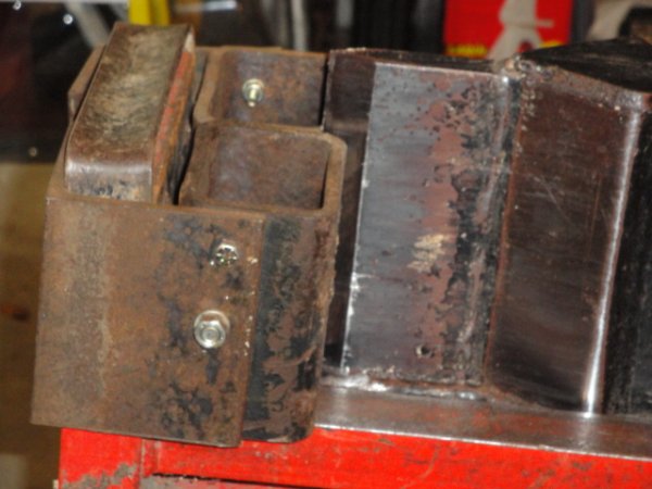

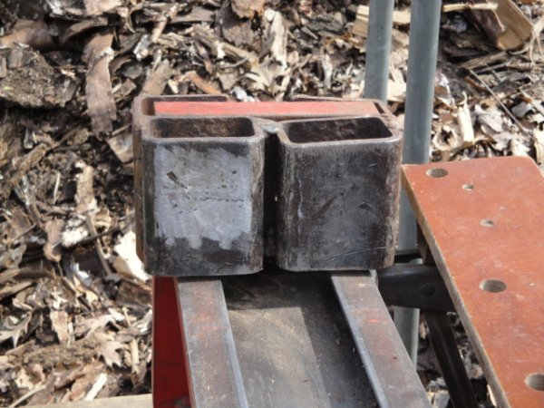

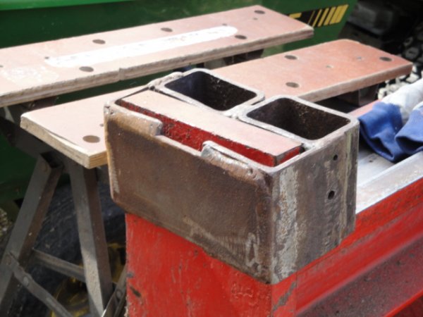

    I came up with this idea to help split elm. I first bolted it together but then I had it welded. It keeps the wood a few inches from the base and allows the wedge to go all the way thru the round. Since it is steel, it won't fall apart like using another piece of wood.

    Wow Eric, you gotta patent that thing! It's ingenious, and I'm sure it has other applications besides stringy elm.

    That well definitely help on a H/V splitter. I still think a push through splitter is best for elm though.

    A push thru splitter would be best but this old Speeco is what I am stuck with. Does everything I ask of it and doesn't work any faster than me:BrianK::BrianK:
