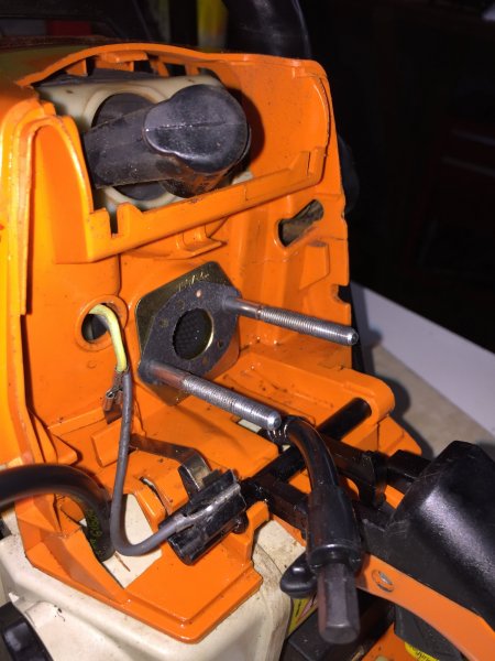

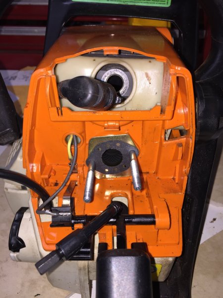

    Pull air filter and carb off and post picture. Only take off the carb, linkage, and air filter.

    Here ya go

    Now take gasket off, make sure hole in metal plate is lined up with impulse hose port and gasket is as well.

    The carb is getting fuel. The new one has gas in it and the line is purged. I had to cap it with a torx socket so I think compression is good. Again, it fires and runs at about 3/4 throttle for 2 or 3 sec and then dies when I spray. Nothing unless I spray. Th
    well, that worked. Kinda. I have a off brand gasket because the stihl store didnt have that gasket. It fired with spray and I kept it running for about a minute. It wouldnt idle. Now, It wont crank on spray lol. Gettin closer!

    haha man not at all. I know you are trying to help. Its getting closer. That hole was covered up partially tho. Im sure that had something to do with part of it anyhow.
