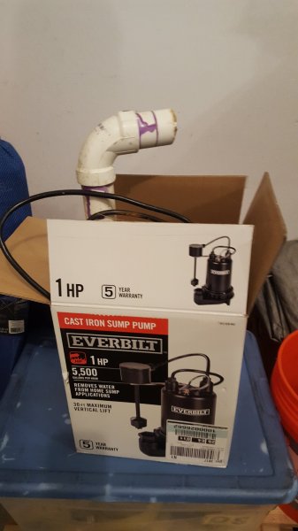

  15. eatonpcat
    10,274
    58,413
    Just installed this one a week or so ago...Home Depot special, but it should work!
