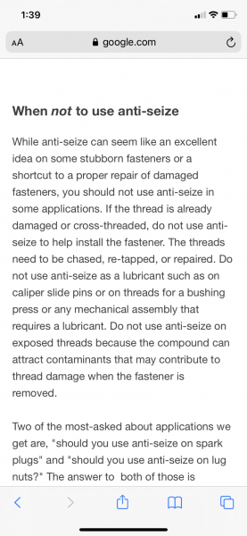

    That’s a pretty common issue with those rear pins. My son had the same not long after getting his 05 TL. They were probably neglected since new.
    I agree Kevin. I’d much prefer antisieze in there over a grease. Just my experience.

    I'm on both sides of this issue...I've used AS on slide pins plenty of times, it worked ok, but the next time I took it apart (several years later) the AS was dried out and the pin, while not froze in place, was not sliding freely...I went back to using "brake grease" and have been seeing better long term results.
    The other issue I've had was here recently at work, where we use AS alot! I had a stainless shaft/hub assembly that I coated with AS before putting it together (as recommended by the OEM) the hub gets heated to about 250-300* so it will slide over the shaft and can be pinned in place before it cools/shrinks (a light press fit) This particular piece had never been apart since new, and I expected a fight because it spent the last 8 years or so in a damp nasty atmosphere, but it came apart fine.
    After reassembling the shaft/hub we quickly realized that there was an issue elsewhere and the whole thing needed to come back apart again...should be easy since everything was new and coated with high temp AS, right? NOPE! We had an epic battle getting it back apart...when it finally did come what we found was hard thin flakes of AS between the shaft and hub...making the "light press fit" into a "tight press fit"! :hair: It went back together with some high temp grease the second time!

    Well put, I’m not saying AS won’t work more there are more longer lasting products out there. Had a few come backs with AS, witch meant I had to repair on my own time so my opinion might be a bit bias.

    That's another good thing about using grease rather than AS….in 2 years when you replace the pads the grease is all gone and the pins are just rusty. No AS on the finners :D:zip::picard::deadhorse:

    Yes, it now sucks for slides. I've heard the temperature is too high for the silver stuff.
  14. brenndatomu
    25,146
    163,440
    Standard AS is good up to 2000*(ish...varies by brand a bit), the high temp stuff (nickel based) only buys you another 4-500*
