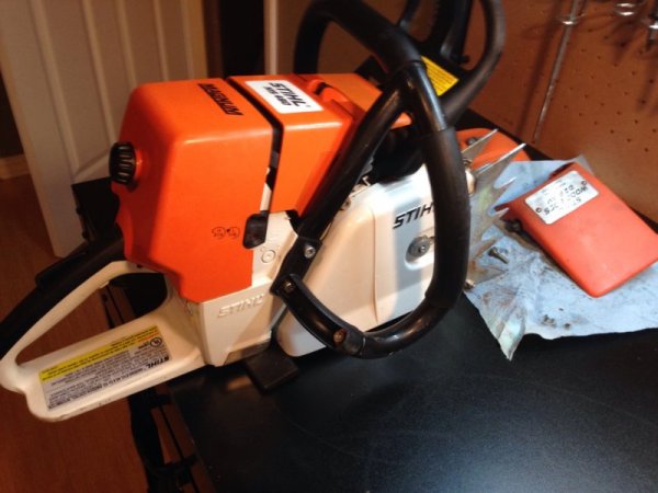

    Yep, 10mm. When I went to look at it my biggest concern was the cyl. May have been replaced. It has newer OEM piston, crank bearings and seals, clutch. But the cyl. Is original. So mechanically it is in good order, with good compression. Looks like it needs a carb kit, muffler screen, and the little black piece that you slot a screw driver into to adjust the carb. And a good clean. It is well used but runs strong. Amazing how different it sounds from the 12mm I have. Got a nice nasty sound.

    Here it is back together, but I must say it is in pieces again.
    With the 12mm.
    When I looked at the saw everything seemed fine, the only thing was the idle was high but otherwise the saw ran fine looked good mechanically. After cleaning I fired it up and started tuning it and it wouldn't tune. Pulled the carb: it has had a recent rebuild, pulled the H and L screws and the L screw had a bunch of gunk on it cleaned the rest of the carb and put the saw back together. Ran better but still wouldn't tune. Started suspecting an air leak and sure enough the carb boot has a crack in it.
  17. DexterDay
    DexterDay Administrator
    12,411
    31,637
    Northeast Oh
    Good catch!! :thumbs:
