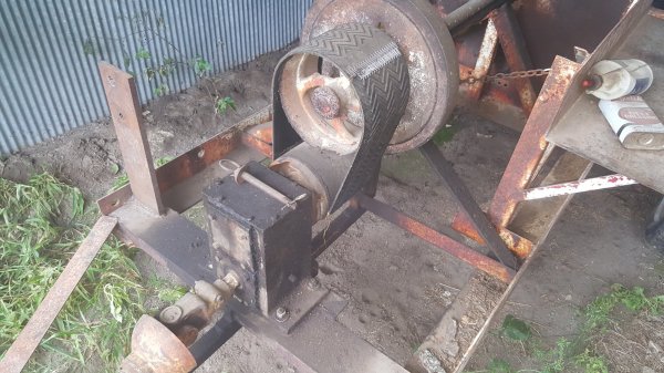

    That's how mine is,
    Don't ask me where the gear box is from,just parts laying around. Flat belt is from a round baler.

    NICE!
    I really need to find one and set one up with a separate engine only so I could use it with my log loader as a slasher.
