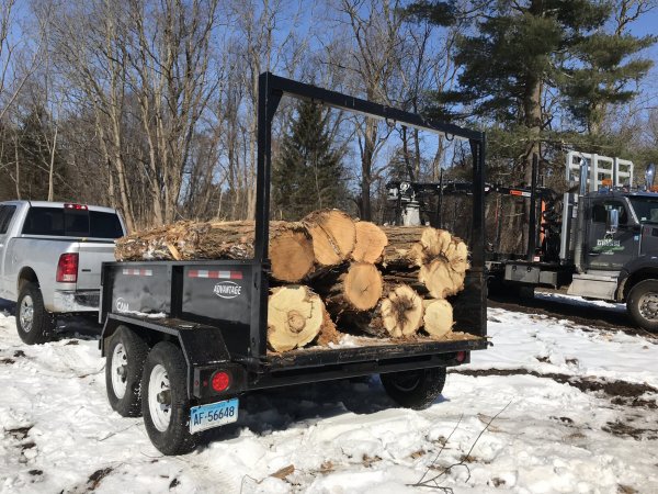

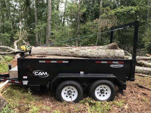

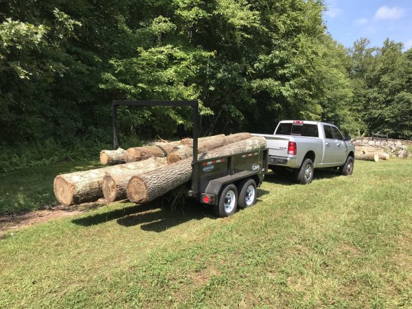

    I ended up with a Cam 6x10. I wanted the lowest deck height. My body is just too broken up and over the years I’ve noticed how much easier it is the lower the trailer is :)
    When I rebuilt my woods trailer I went so far as to flip the chassis upside down to make a low rider out of it. Lost some ground clearance but so much easier to load by hand.
    if there’s one thing I don’t like about the cam is it’s tailgate design. Barn doors would be better. Not sure if that’s possible with the lo profile deck. When scrounging logs it doesn’t matter much anyway. The tailgate stays home.
    If I were to do it again I’d go 6x12. I wanted small with the intent of going in smaller spaces.
    I gotta say this Cam trailer is built a lot stronger than I thought it would be. After seeing so many used ones rusted and smashed I thought they were just tin boxes.
    I’ve done some minor welding to the rear pockets while adapting it to a log loader. Was very worried my idea would tear the back of the trailer right off. It’s never budged, groaned or even whimpered no matter how big a log I hoist aboard.
