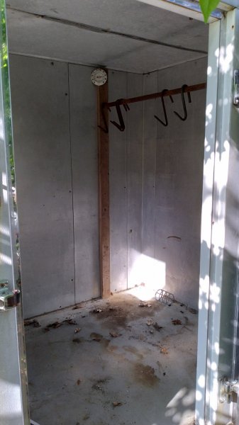

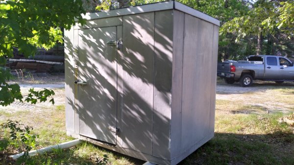

    My search for a walk in cooler has finally ended. Over the last few years I had plans to build one or use a reefer box but it just hadn't happened yet. Yesterday i find out that a friend of ours who's moving to WV doesn't want to take his walk in with him and needs it gone so the house can get listed. I made a quick phone call and they said come get it, it's yours! :hair:. Dad and I went over this afternoon to load it up and bring it to it's new home.
    He was cooling it with a 5k btu window unit and coolbot. He kept the ac and coolbot for his next project in WV but I'm not complaining. Couldn't beat the price (free!). I can't wait to get this thing set next to the shop and ready to hang some deer this fall. Can you guys recommend a good roll on coating that I could apply to the floor for easy cleanup?

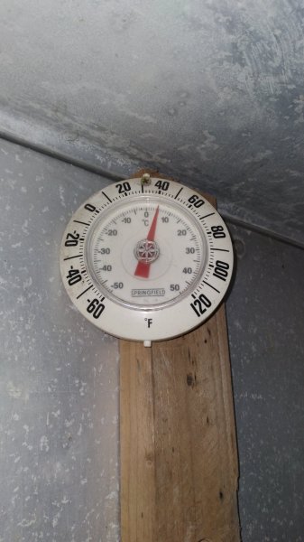

    Nice score Jeff. What kind of temps would it chill to?

    Thanks joe. He said it would hold 40° consistently without a problem.

    I would be tempted to try a pickup bed liner product. Might be worth some investigation.

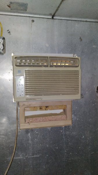

    Got the window unit installed in the cooler today and gave it a test run in the 90° humid air. I don't have the coolbot controller yet but it brought the inside temp down from 85° to 60° in about 45mins.
    The previous owner had a casement window ac unit installed but i had a standard 8k btu unit laying around. So i cut the hole to size and framed the extra space in order attach sheet metal and insulate.

    BCB it's outside but right at the back of my shop. I normally take deer in the back door to where i butcher them so this will give me the opportunity to let them hang as long as I want until I'm ready to butcher. Then it's just a few feet out of the cooler and into the shop.
    I was hoping to fit it inside but it's 3" too tall :(.

    Some painters plastic on the floor right under the critters would keep drippings contained for a temporary fix.

    You could just use a good concrete floor paint then use a couple of those 3'X3' galvanized drip pans for under your car. Put these right under the carcass. Added benefit is you can take the pans outside and hose them out!

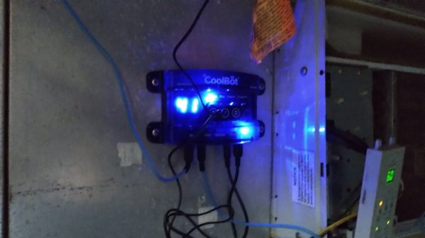

    And we're in business! Got the coolbot hooked up and gave it a test run. I still need to clean all the wiring up but I was too excited to test it. It brought the inside temp down from 81° to 38° (the temp i set the coolbot to) in about 2hrs. The compressor shut off like it should and the fan stayed on high to keep the coils from freezing up. It was an expensive little gadget but IMO well worth it. The temp rose a few degrees after i had the door open of course. Can't wait for bow season!

    Awesome! How big of an AC unit did you use?

    BCB i used an 8k frigidaire that I had laying around. Thankfully it gets the job done.
