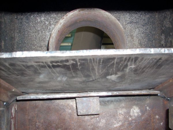

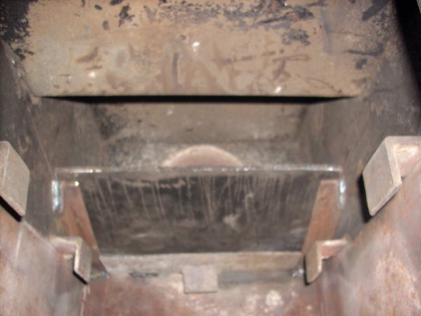

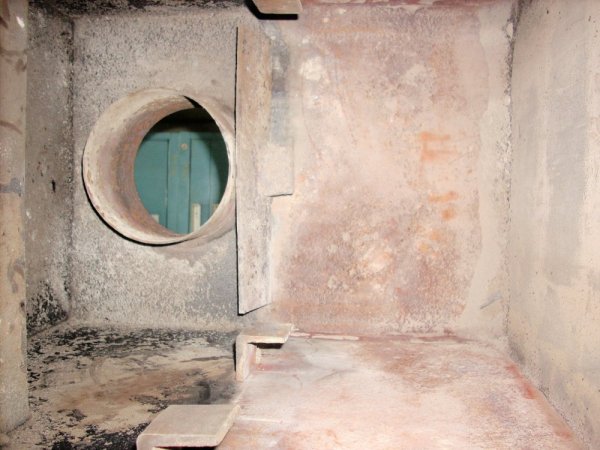

    Jetjr, Here are some pics of the baffle I installed in a baby bear fisher. You can also set a plate on top of some fire bricks snugg against the side of your stove. I welded in some angle iron on the sides of the stove then set the plate on top. I used 3/8" plate but you can use thicker if you have it, doesn't hurt! I wouldn't use any thinner though, it'll warp after a while. Having the baffle will help emensly, slow the burn down and help it become much more efficient.
