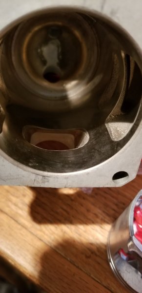

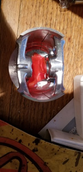

    I heard the pistons in these kits were not any good. Have you heard this? I have not heard of any failures but the Hyway piston I put in mine when I rebuild it was beefier than the cross.

    No. Never heard of that. What probably happened was, on the downstroke, the rings hung on the exhaust floor and busted the top of the piston off.
    I've had Meteor, FT, and Cross in front of me at the same time and didn't notice anything alarming between them. Meteor was more shiny and may be more consistent in size, but I didn't mic them
    Horkn and brenndatomu like this.

    Its certainly worth a shot but the plating on some of these am cylinders is a crap shoot.
    You will probably find by the time the transfer is gone the plating is hosed.

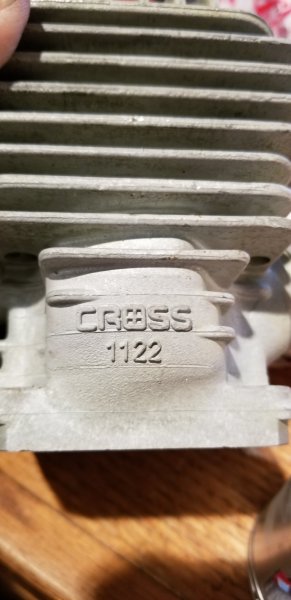

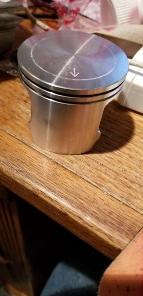

  14. Stephiedoll
    Stephiedoll
    4,141
    29,743
    Omaha, NE.
    piston
    Hammy, basod, Redfin and 8 others like this.

    Make sure the piston does not bind sliding down into the bore. I have two Cross kits here where the bottom of the cylinder is way to tight.
  20. brenndatomu
    25,306
    164,742
    My chicom piston skirts kissed the crank just ever so slightly when I first checked it...enough to have caused problems for sure!
