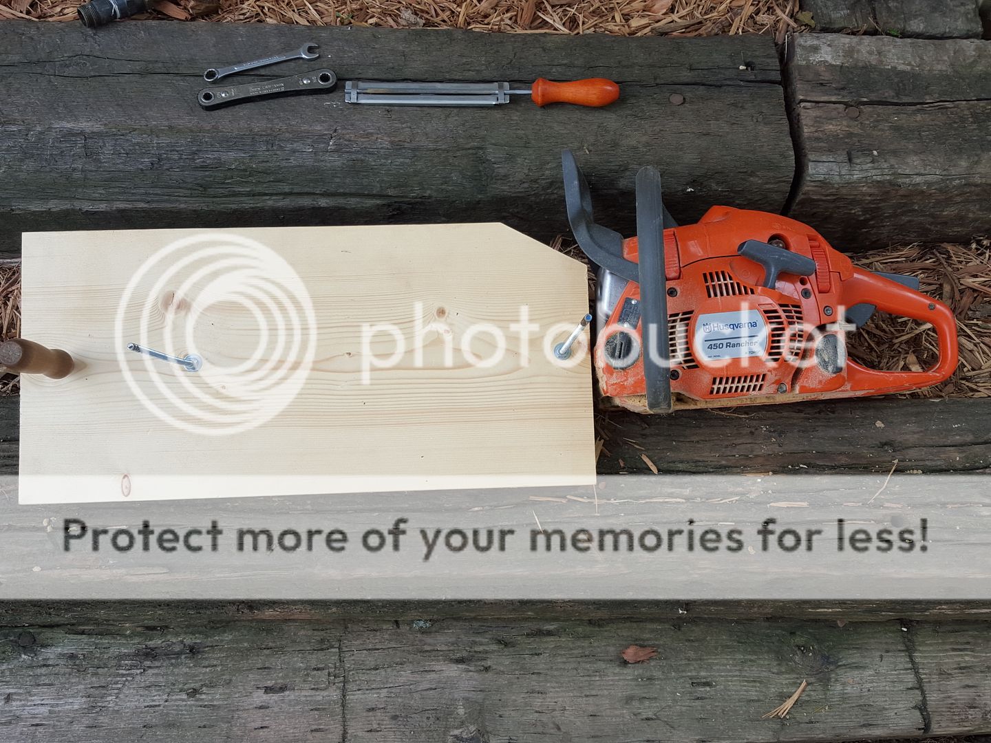

    It's on the first page of posts...I used wood instead of steel with blocks that change out for different depths.

    What size threaded rod are you using? 1/4" ? Or larger.

    Yes 1/4" ... good eyes.

    I'm actually useing 2" grade 5 bolts with a nut screwed all the way up so I got more meat there to weld to, and the bolt and nut will lie stright in the angle steel. Also a grade 5 bolt is way stronger than all thread. Yes sir 1/4 in.

    Oh yeah. Use good washers one on top and bottom of bar with a lock washer between the bottom washer and nut. This will spread out the pressure, and protect your bar.

    Does it "feel" rigid or secure enough for you? Just wondering if I would be good with 1/4" or bump up to 3/8" if/when I make a little mill unit such as yours.

    I does feel good. I think that using blocks help to resist it from twisting out of plane as I push into the wood. I had a hole in my bar near the tip already that I used. It only could accept 1/4" which also was a factor.
    Less drilling into my bar the better. :)

    Made a slight modification in the guide board. Once I dropped the spacers down in depth to 2" I needed to make room for the brake.
    Four 2" thick slabs so far! :)
