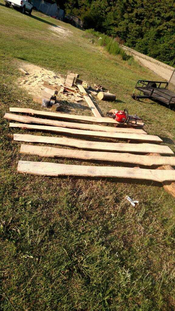

    Those homemade slabs look good to me!
    I didn't consider that the bar might wander without a spacer. I was just thinking how to simplify your version (for my saw) and possibly gain 1 1/2" wide on your design. I only have a 16" bar, so it might not even be practical lol.
    Did I read somewhere that slabs get a coating of latex paint or beeswax on the end grain to prevent cracks or checking while they dry?

    I was just going to ask if that's what I should do. :)

    Not bad for a start. Good job.

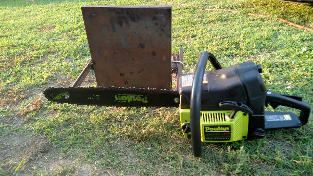

    This is my first successful mill on a 3450.

    Some cheap exterior werks well for end grain.

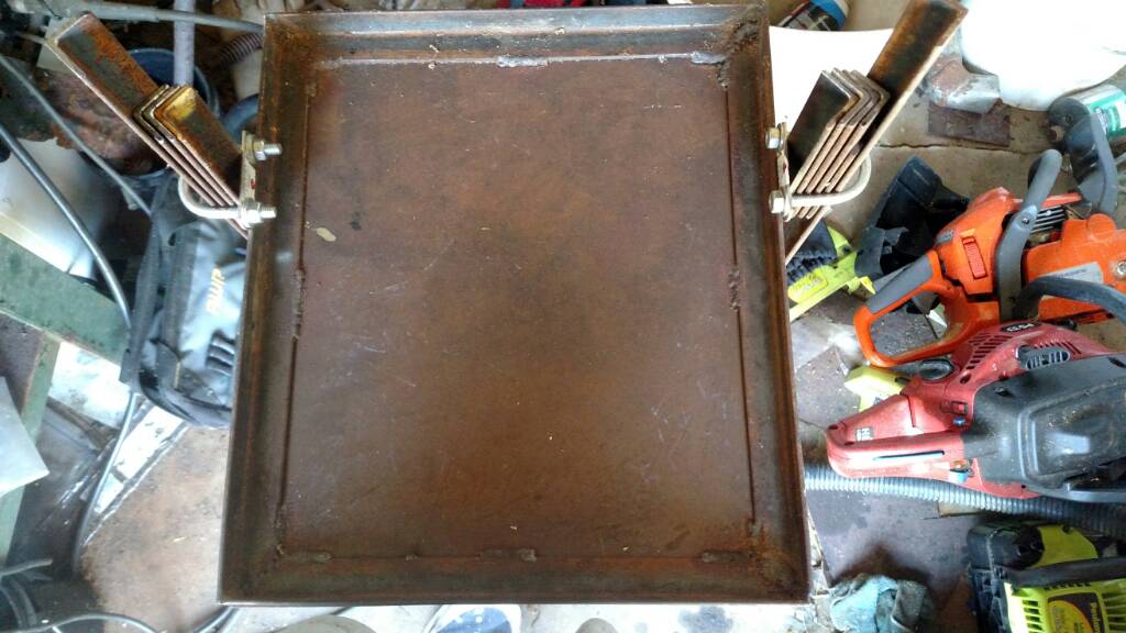

    Do you have a photo of that unit from the other side?

    Saskwood.. I don't have a pic of the other side, but I will take one for you bud. I'll try to remember to do it after werk today before Church.

    Sorry sask was a busy afternoon, didn't get that pic for u. Off tomorrow will do it then.

    I can tell u that u don't want one like I milled that with. U can't keep it together. But the pic I posted of the poulan is 1" x 1/8 angle frame MIG welded to a 14guage steel pice of sheet metal. With same angle steel for legs to mount to saw bar with pices for spacers and u bolts for the adjustment on thickness of cut. Which can be marked for different cuts. Oh and used a 3/8 thread bolt set inside angle steel and welded in place. 1/4 for tip end of bar same weld. When marking for thickness of cut allow 10% extra for drying (shrinkage) pine is worst those I cut in the pic were 7/8 and shrunk down to 3/4. Any more questions I can try to help.

    Here u go sask. Still needs a handle, ain't used it enough to decide exactly how I want it

    165
    Bottom edge of pic is front side of mill.
