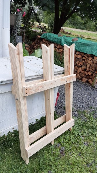

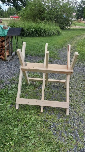

    Old one fell apart so I built a new one with a few 2/4's. Made it 16" between centers so it is easy to lay out the wood for a 16" cut. Total width is 33 1/2". Ran a piece of threaded rod through it so I can collapse it to take less space. The 2/4's on the outside also serve as stops to keep it from spreading. Sawbuck folded.jpg Sawbuck opened.jpg

    Was a little lazy - didn't take the time to dado the joints - maybe next time
