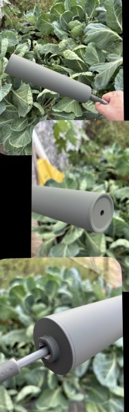

    TA-DA!
    Chaz, brenndatomu and JimBear like this.

    Thanks. It’s really quiet. My son just ran a full magazine (4 shots) through it and said it didn’t bother him at all.
    Chaz, JimBear and brenndatomu like this.
