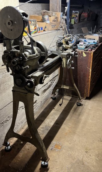

    We spent the evening cleaning up part of the basement, moving some things and making more room so we could move the lathe. The headstock was close to a wall, so it had to be moved to the right to fit barreled actions.
    I made riser feet for it too. It was too low and I had to stoop a bit to run it, which made me very sore. I used hockey pucks and carriage bolts. I recessed the bottom of the pucks for the head of the bolt so it wouldn’t touch the floor. They raise it about 3.5” after leveling, which is about perfect. The feet prevent vibration transfer to the floor. It was pretty bad with the feet directly on the concrete.

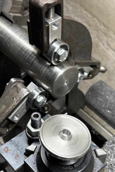

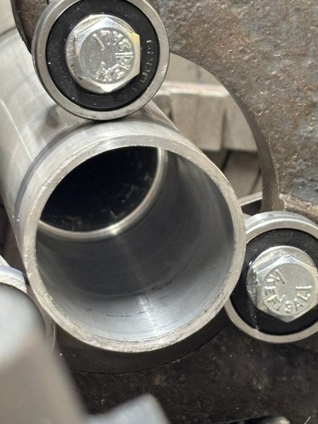

    I worked on the blast baffle a little. I had to set up the steady rest, but the stainless likes to gall, so I will be adding bearings to prevent that. I prefer a roller rest for most things anyway and it’s something that needs to be done anyway.

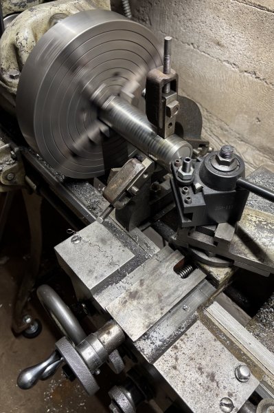

    The new boring bar was a bust, literally. I had a piece of steel laying in the shop that would work, so I chucked it up in the lathe and broke my parting blade. I don’t know what that stuff was or where it came from, but it does not like to be cut. Even carbide didn’t work on it. I tossed it in the scrap bin and ordered a couple of bars of the interweb. They should be here tonight and I can see if they do a good job.
    I did get the blast baffle done. The 304 cut like butter compared to that hard stuff. No complaints about it from me.

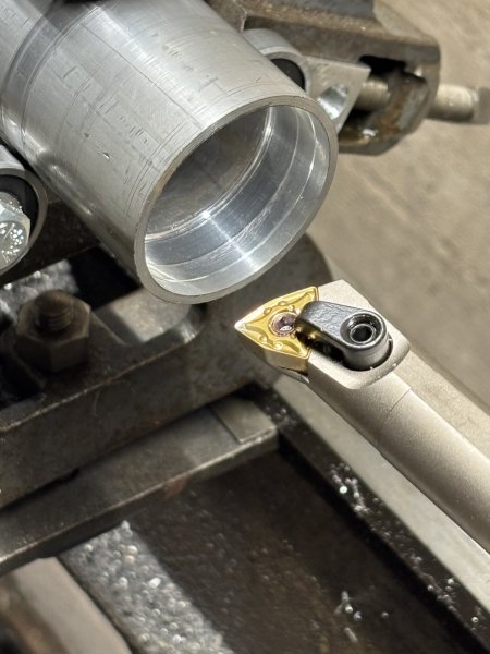

    I tried out the boring bar tonight. Fiddled with it for a while on the part of the tube I had to trim off anyway. I got it dialed in, cut the tube off, and got right to work. The bar worked beautifully. I have not used insert tooling before. Only hss and brazed carbide. I prefer hss over brazed carbide for most stuff. This insert tooling is pretty slick. Each insert has 3 corners and 2 sides, so you get 6 corners to wear out on each one. I don’t know how long it will take to wear one out, but I guess I’m going to find out eventually.
    The tube is bored out to size and the blast baffle is a nice fit. A little tough to get back out, but once it goes together it will probably stay together. I have to thread the ends of the tube and make caps/baffles. It should move along quickly now, as long as I have the time to work on it.
    I still have to thread the barrel, but that won’t take long. It takes longer to get it running true than it does to cut the threads.

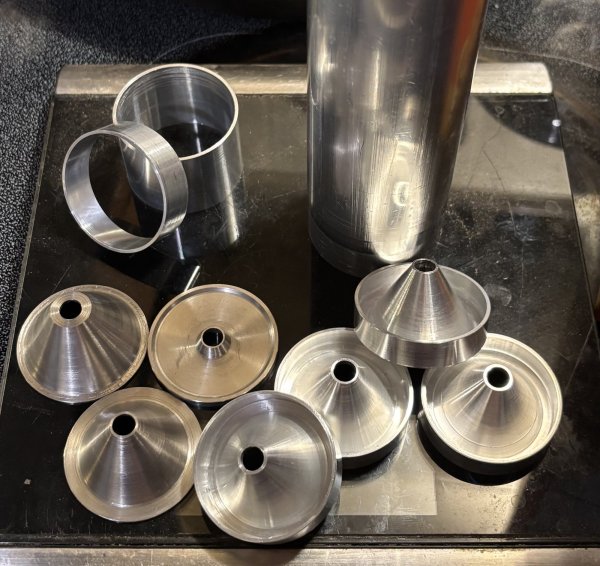

    I have been a bit busy lately. I have fiddled with the suppressor here and there. I spent the last 2 nights making the rest of the baffles. All I need is the end caps and it is done. I do have to clip the baffles, but that doesn’t take very long.
    The 4 “deep dish” baffles on the right are aluminum.
    The flat and 2 cones on the left are 304 stainless.
    The 2 spacers and tube are aluminum.
    The tube is still full diameter, so it will lose some weight when I turn the outside down to get to my final thickness.
    I ordered a sig taper hub adapter for when I buy a commercial can. It is supposed to be 1/2”x28, but I don’t know what their thread tolerance is. I can hit a thread diameter with wires, but I will wait until the adapter gets here to thread the barrel, just to make 100% sure it fits right.
    This puppy sure looks good with the internals in it. I hope it works well and holds up to the 22-250.

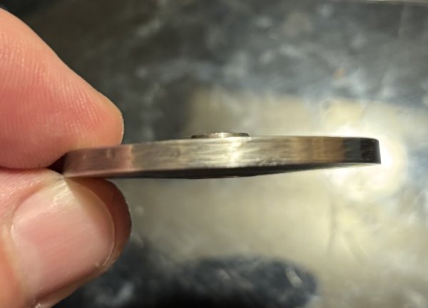

    I tried the suppressor tonight. The first shot sounded like someone unplugged an air hose. Just a quiet hiss. Absolutely amazing for a 22-250. The second shot was a bit louder, but it could have been because I had moved right up against the wood pile. It could have also been because the baffles were warm and could not soak up as much heat.
    Heat was no big deal. It was warm after 2 shots but not too hot to touch.
    The baffles held up just fine. The stainless blast baffle did not. It bowed under the stress, even with a giant expansion chamber. My plan originally called for a larger hole in the blast baffle to bleed off pressure faster. I don’t know if a bigger hole would help or if it bowed from the impact of the high velocity gas. I figured 304 would hold up, but I guess I need something better or at least a more robust shape.
