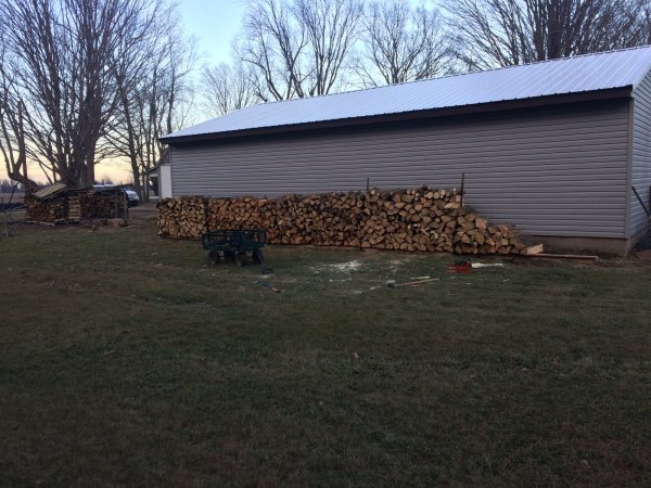

    Trying to get ready for next year when I start using this thing, have no idea how much wood to expect to burn so I am getting as much as I can IMG_0688.JPG

    OK, that's the first two weeks...watcha burning after that?! :D
    JK :whistle: (kinda...OWB's do tend to be a lil gluttonous, Dad uses more in his OWB in a month than I do in my IWB all year, to be fair though, he is also heating much more space than me too)

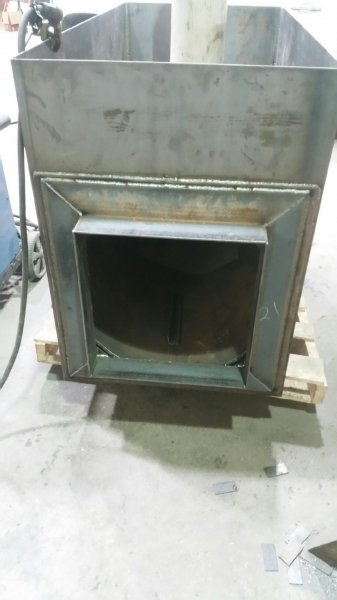

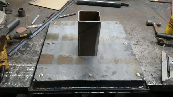

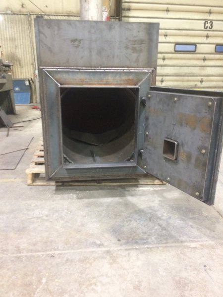

    IMG_0702.JPG Got door frame and door welded up today, frame opening is 21"x20". Left a 2" raised area in door to add a baffle insulation, and have a 4" piece of tubing going through for my air intake IMG_0700.JPG does anyone know of a web sight or place where I could order a 120v actuator cylinder to open and close damper? IMG_0698.JPG

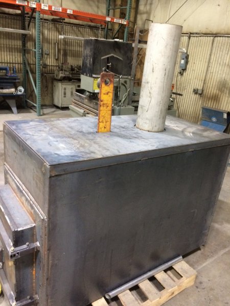

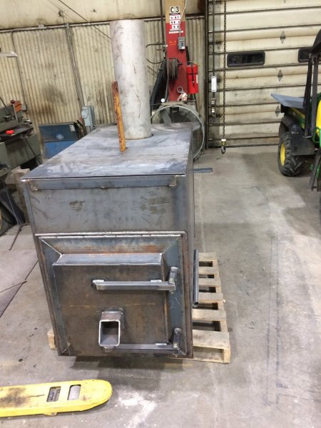

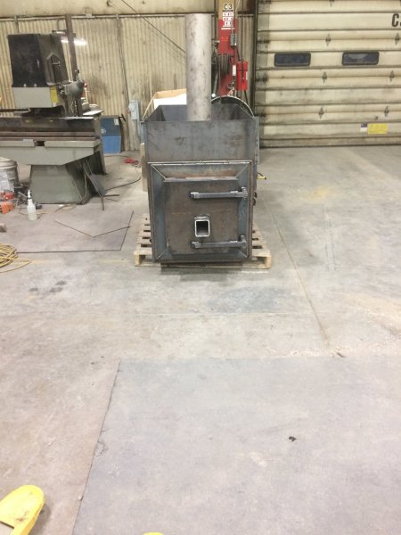

    IMG_0768.JPG Finally got back to working on this for a few minutes today, door is hung on the hinges, now I need to make a cap for my damper tube. IMG_0770.JPG

    IMG_0839.JPG IMG_0840.JPG Finally got a little time to work on this again, got a lifting lug on and top cut and laid on, now just need to bolt too down, come up with a damperner control, and light a fire to check everything out, can't wait to see how it will work!

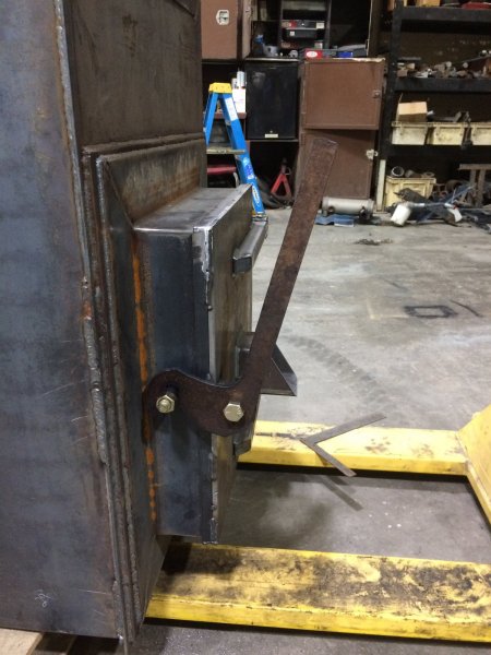

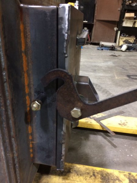

    IMG_0844.JPG Got door latch put on, needs cleaned up and some slight adjustment, but very happy with how it turned out IMG_0842.JPG

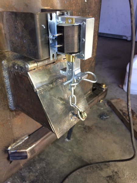

    My central boiler unit uses a magnetic actuator to open draft door. Didn't read entire post to see if it's been said already. I like it. Seems like less to go wrong vs a motor.

    That is what I ended up ordering. It was pretty cheap and about as simple as I could get, and in the event of a power outage the draft door would just fall closed shutting air off to boiler

    Also forgot to note.... My draft inducer (highly highly recommended) is on the same circuit. When the door opens the fan comes on.

    IMG_0924.JPG Got my dampener hooked up, put ports in for my thermometer and aquastat. Getting close to wiring up temporary and letting it burn a few days to make sure all is good before insulating! IMG_0925.JPG

    I'm concerned that you won't get enough air through your 4" inlet without a good sized blower, but that's just from what I've seen and building a few smokers that don't need much air. Any up dates?
