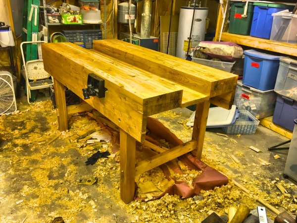

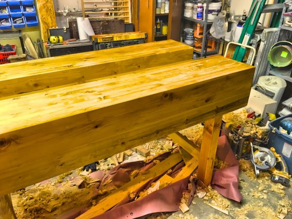

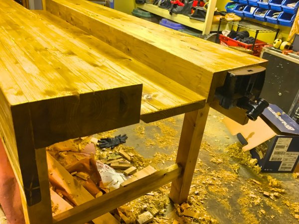

    Barring a few enhancements (dogs, etc.).... DONE!!!

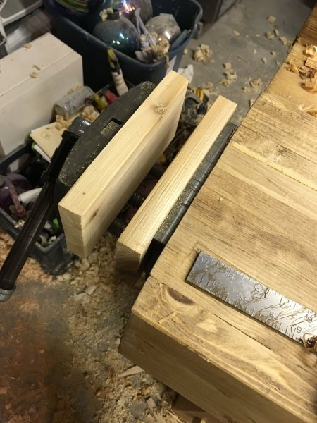

    Wooden jaws in the vises IMG_7818.JPG IMG_7819.JPG and waxed everything. Almost done!

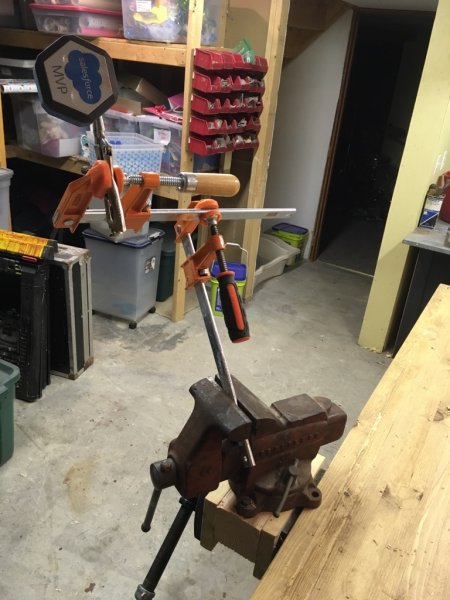

    IMG_7850.JPG IMG_7853.JPG IMG_7856.JPG Built a "vise in a vise" jig and otherwise cleaned today. Goofed off... speaker held by vise grips in a clamp in a clamp in a vise in a vise lol

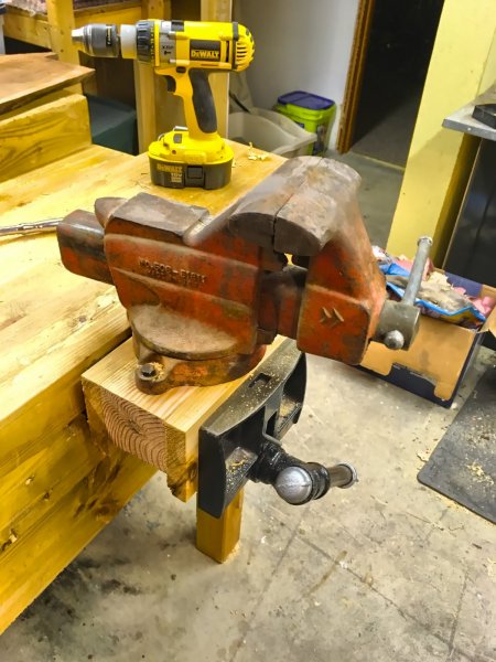

    Are my eyes deceiving me or are your vises not flush with your bench top?

    The jaws are 1/4" down the wooden pads are flush so if I resurface the bench I won't hit metal anytime soon.

    I thought that might be an optical illusion.
    Pads are easily replaceable and modified :) hard maple will stand the test of time

    I find auxiliary vises are more stable with a 2x4, jointed true, glued and screwed to the bottom of a base top support, 2x4 is clamped into the Jaws base support is supported flat across top of The Woodworking vise, more contact points, more stable :)

    True, I did not engineer this very well was in a rush! I will probably make a T shaped support where the bottom dados into the top and then most of the weight will also be on the bench vs. inside the vise.

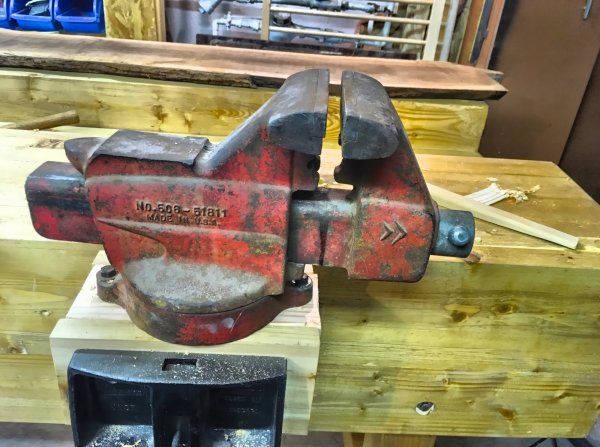

  19. Garry Polmateer
    Garry Polmateer
    Oct 3, 2016
    324
    2,150
    Alplaus, NY
    OK I'll take a few. It's a 1960s craftsman which I was told was made by Columbian, so actually a pretty decent vise. Got it from a relative's estate. Could probably use a new set of jaws and some lube but otherwise in great shape.
    JIMBETHYNAME likes this.
