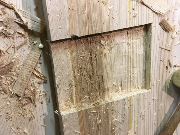

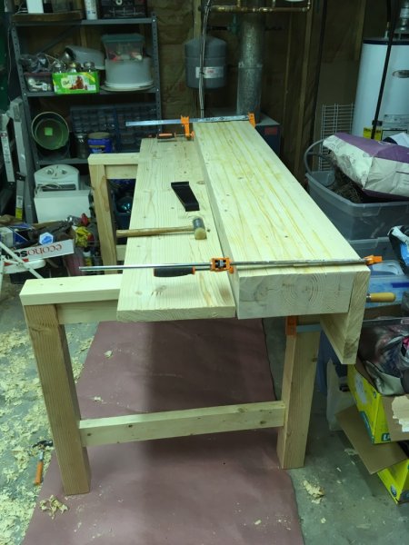

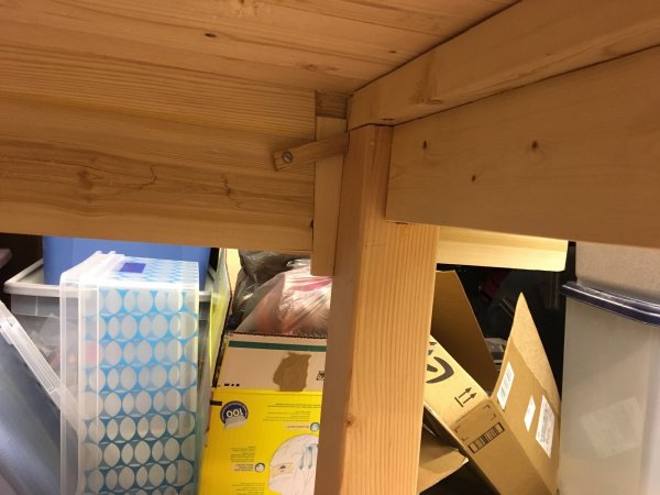

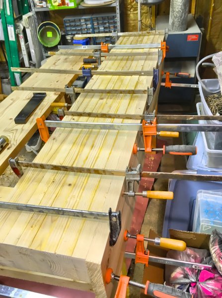

    IMG_7684.JPG IMG_7688.JPG IMG_7692.JPG IMG_7691.JPG Lots done today! Cut one apron's housing dados. Cut wedges and stays, first test fit followed by gluing the back benchtop to the apron.
    I must say, the end is in sight!!!

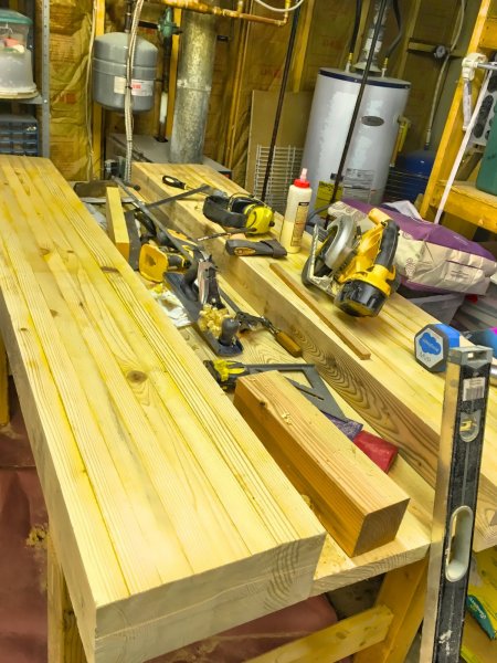

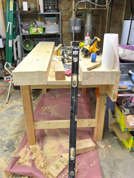

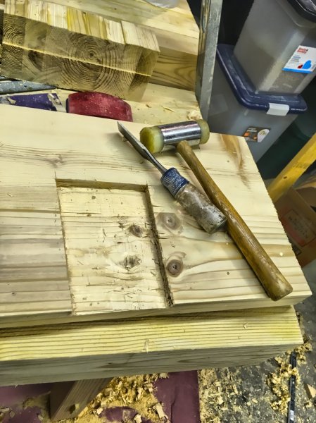

    Using the. Ench to build itself! Bummed that this top had a. It of twist so I am planing it back to flat and the. i will start cutting the vise dados and finally the apron.

    I know know you are following this guy Peter Sellers plan, but ive never seen that wedge detail before or the apron being dadoed like that on anything ( been doing woodworking a long time both pro and hobby)
    Just curious, how wide is your bench?

    About 36" wide and 6 feet long. The wedges worked great to stop racking and only two installed and let the bench be disassembled if needed.

    Sorry. I didnt realize that the dado was bigger than the leg with the wedge in there. I thought it was glued.
    I never built a takedown bench before. I always built them to never come apart.
    Quick ? How is the top attached? Just by the apron and wedge? If so you are going to adjust that wedge when it expands and contracts.

    The more i look at it, its a pretty ingenious design. I was just concerned about the top moving and splitting . But with the 2x6 on edge it shouldnt be a problem. Wood gets wider not longer(lol no homo)

    I'll pound in the wedges until they don't move anymore. The apron gets a carriage bolt through it once that's done. The bench top will be lagged to the bearer up from the bottom.

    In my basement which is very dry and the humidity is consistent. I didn't let it acclimate long enough (about a week) hence the twist in the top. I can fix it with some planing though.

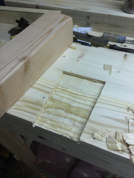

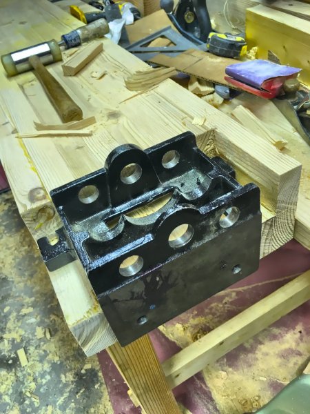

    IMG_7703.JPG One more dado cut. That is all for the day!
