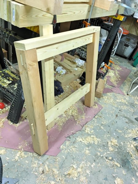

    Second set of legs done, glued the bearer on and started prepping the tops to cut to length. Also cleaned the shop a bit since it ks a disaster area.
    Hope to start cutting leg housing dados tomorrow.

    Im not too sure that I would have just glued that bearer on top of your legs.
    Once you have expansion and contraction, that bearers going to crack. Wood moves, but the glue doesnt.

    Too late now! Just following along with the instructions from the Paul Sellers blog. I hope it doesn't crack or if it does, that it does not impact the performance.

    If it does it will probably just be cosmetic. Skirt should cover it.

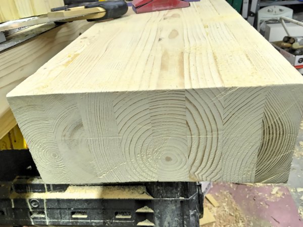

    IMG_7659.JPG Cut one of the benches to length, that's about all for today! The lamination was good at least. My cutting.. I need some more practice!

    Looks BEEFY! I like how you alternated the rings. Makes it alot more stable

    I will be honest - that was an accident haha but good to hear the feedback, will do on purpose on future projects! I am still a total novice!

    Gotta' start somewhere.:thumbs: That's MUCH better than my first attempt at making something.
    I've been a "woodworker" a long time, and I still learn stuff all the time.
