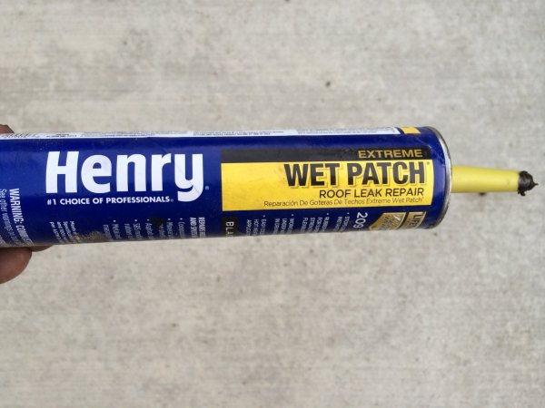

    Today's final step! ! ! - This is the best we can do folks!
    The 7 tubes of Premium Henrys with the lifetime guarantee or what is known as Black Jack flashing sealer went on today.
    As a test, every drop of condensation from the air conditioner rolled down the roof and jumped off!
    See pics

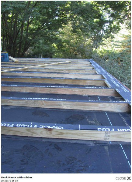

    Don how new are the deck joists?
    I'd worry about adhesion with newer PT joists, looks like a nice install - only thing that would give you pure waterproof guarantee long term would've been SS L flashing from the roof decking up sides of joist and then install the water membrane over top of joists
    wildwest likes this.
  7. don2222
    don2222
    Nov 10, 2013
    3,438
    4,874
    Salem NH
    The new joists tops are all covered with Grace ice and water shield and sit on top of 2 layers of Grace I & W and are bolted to the interior joists which lye under the Advantech.
    No water leaks when it rains.
    wildwest and basod like this.

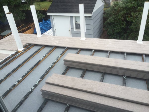

    Thanks for your comments. That is why I put polyglass over the Grace. Just to protect the Grace. The polyglass also seals up like the Grace with no nails.

    Time for the Fiberon!

    Still no leaks and almost done !
    Click to enlarge:
