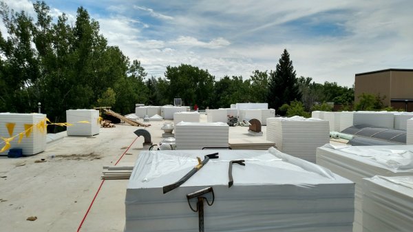

    PART_1439946120444_IMG_20150714_132021620_HDR.jpg Jr High I am finishing up this week with Fibertite
    basod, smoke show, Deacon and 2 others like this.

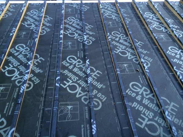

    Hello
    As an extra precaution, we put Grace over the bolt holes that hold the joists down for the decking.
    See pic

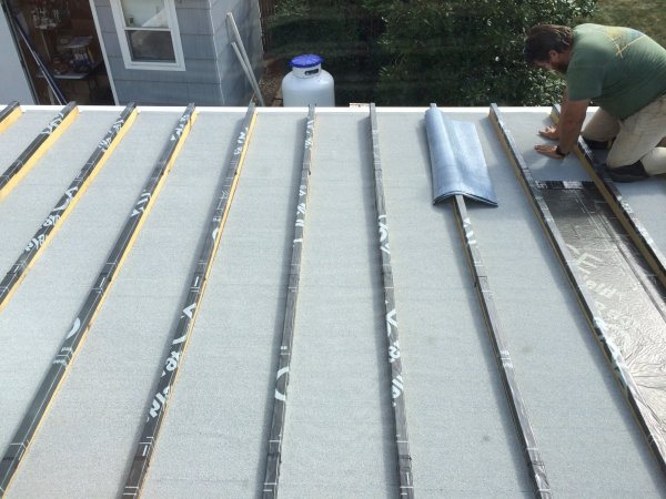

    Got some PolyGlass today to go on top of the Grace I&W to protect the grace before the deck boards go on.
    Is that a good idea?
    see pics

  17. wildwest
    30,744
    145,244
    Sounds like a good idea! Anyone else? (WWW said good way to protect the Grace)
  18. CleanFire
    CleanFire
    Aug 28, 2015
    2,997
    16,525
    Yeah, put something over that Grace before buttoning up the deck. Looking good Don!

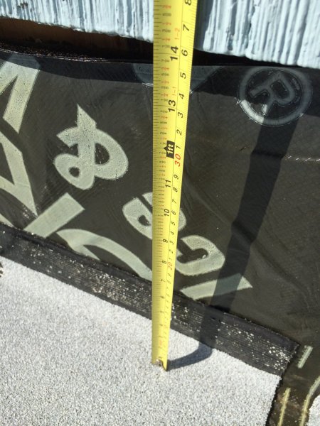

    Polyglass is on over the 2 layers of grace I&W ! ! ! The light color pebble top on the Polyglass will not be harmed by UV rays and will reflect the heat. The Polyglass is tough stuff to cut!
    The Polyglass interlocks with a tab with the same special adhesive that Grace has. Grace goes up 14 inches against the house under the shingles.
    Some builders do a floating deck, but this is not floating, the joists are bolted into the 2x12s below the roof so it is stronger than a floating deck! The 2x12s below are tied to a ledger bolted to the house!
    See pics below. Click to Enlarge
    wildwest likes this.
