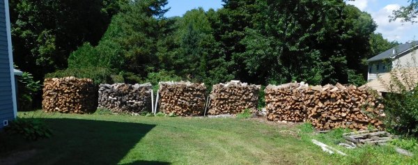

    This is typical of what we are building now (but with more angle in the outer ring- one of these blew out this winter):
    There is somewhere around 12 cord of stacked wood there in a relatively small area.
