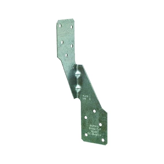

    I have these joist ties to add yet, then purlins and I can get the metal up. I should have enough metal to do the roof, side and back.

    And ties in.
