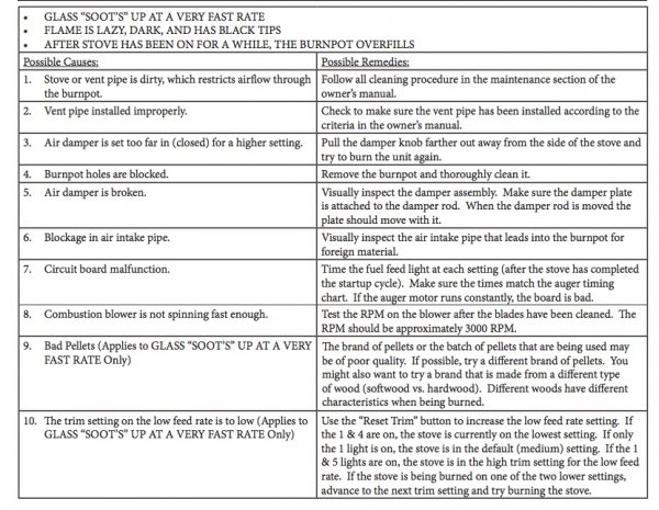

    Don't know if you have the original owners manual, but this is direct from a Breckwell owners manual:

    To help with the clean most of us use an electric leaf blower on suck.
