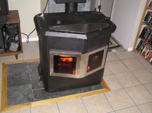

    Having built my last three stoves, I would strongly recommend buying one. The basic underlying problem is that a single person cannot achieve the 'economy of scale' that a production facility can. Even given free access to all the needed components, there are just too many man- hours in a modern stove to make it cost effective.
    My last stove was built with 24/7 woodburning in mind and it did fantastically well as far as loading (a top loader), ash handling (a sealed ash chamber that was 9" X 12" X 30" long- far, far bigger than anything else on the market) and overall user friendliness. It was also catalyst equipped but it was troublesome to keep it engaged in an efficient cat burning mode. It was absolutely better than a pure smoke- dragon but not the equal of a well designed, insulated firebox, 'combustor on top' design. I am now using an Ideal Steel from Woodstock Soapstone and while there are advantages to both stoves, the I.S. is using less wood and burning much more efficiently. And at approx. $2K, I could not duplicate this stove in any kind of economically reasonable manner (and I too have access to sufficient fabrication equipment as well as the ability to design / model the device).
    My last stove that the I.S. replaced: all steel plate construction, all the silver parts are stainless steel fabrications too. Twin windows with fireplace grates used as andirons. A 'door within a door' on top, the small one is 6" square, the medium sized one is 6" X 12", and the large one is 12" X 24". A built-in 2.4 gallon water trough on top, made out of stainless steel welded into the top of the stove, w/ stainless steel cover. The stove is probably bigger than it looks with a firebox of approx. 10 cubic feet (no typo: ten cubic feet). It was easy to load, easy to remove the ash, and easy to maintain in a burning condition. There is a fireplate 10" above the bottom of the stove with a 6"X6" port into the firebox on the right. So reach in with a long handle rake, pull all the coals and ash to the right end of the stove and load wood. But the uninsulated firebox was inefficient, so too was the stove.
    So having been both ways, I recommend an efficient, cat. based stove rather than building anything unless you have some really specific, peculiar need that only a custom will fulfill.
