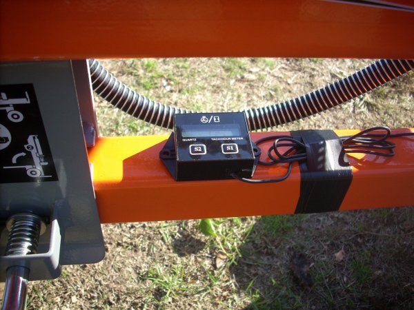

    And yes I added an hour meter to mine before I ever used it. It's a very wonderful thing to have and I picked mine up off ebay as well. It is a tach/hour meter.

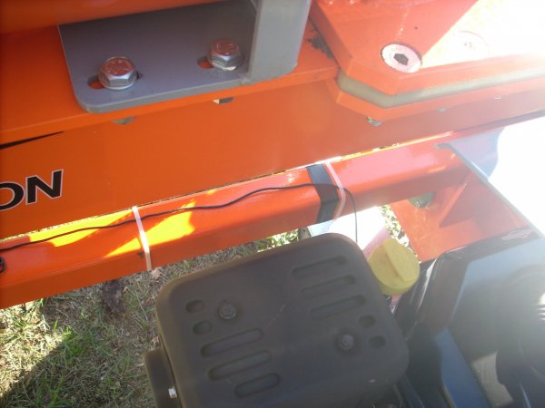

    Yeah! I think mine was about the same $. Easy installation, get ya some "heavy duty" 3M double sided stick tape with the foam in-between, the stuff they put on the meter will not grab long and it'll fall off, doesn't have good vibration qualities.

    I like where you placed that, I used velcro so I could remove easily and stuck it on the air filter housing.

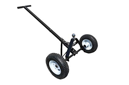

    $100

    I think it's called a trailer dolly.

    This!
