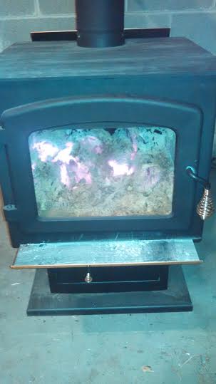

    Let's do this. I want to know also. Pic is my coals from a 7:30 am reload just now at around 3:00 pm.
    I load N/S and these are log forms at the back 1/2 of the stove. I leveled them out (too many to pull all to the front yet), opened the primary air all the way, and left the bypass damper closed. I will check periodically and report in. Loaded with oak and beech this morning.
    Edit: 24 deg this am. 35 deg now.

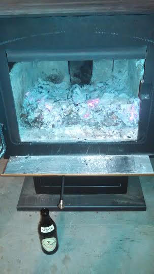

    Raked as many as I could to the front. It was really hot in there.
    Closed the door and the primary air still wide open.

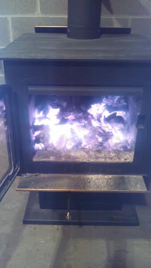

    Coals at 6:00 pm.

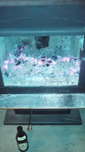

    Coals raked to front 6:00 pm.

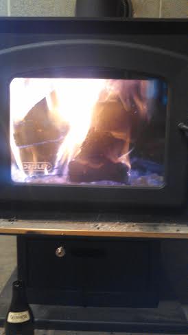

    Reloaded and about to set the primary air 6:15 pm.
    About 3 hours to burn down the coals and reload. 10.5 hours between reloads on my setup.

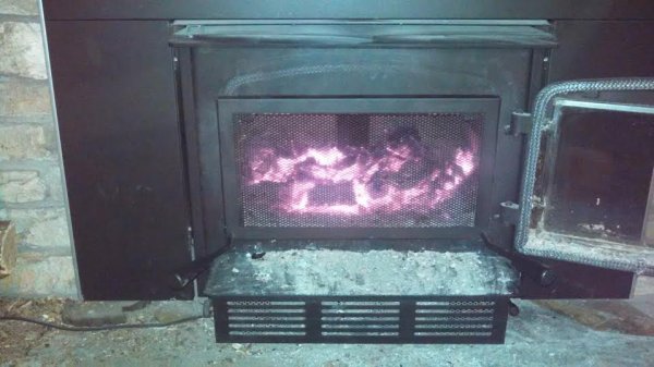

    Now for me to deal with the coals on the Drolet 1800i upstairs. I do have the screen for that unit. It does help to burn the coals and also provides much heat while it is burning the coals.

    Just a little hint here but me thinks you are mistaken about the coals. It looks to me there is still lots of wood in there and that is normal. There is lots and lots of heat to get out of that load.

    I absolutely and wholeheartedly agree, for sure. Normally I do not touch the stove at this point. Sam was bewildered with the amount of his coals, and the length of time to burn them down. The Myriad will produce lots of coals during the heat cycle. We discovered the coals were normal, and they burned down relatively quickly, if you are patient. When I reloaded at 6:15 pm, I did not touch the stove until 8:30 am. Had enough coals to restart, quickly. That process is what I normally do. I really did not know how long it would take to burn down the coals, intentionally, on the Myriad so I tried it.
