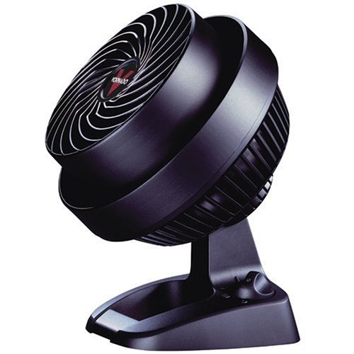

    HD is right. It does matter a lot where the fans are placed and they also should be run on low speed. And this part about cold air being denser, yes and it is why it is difficult to push warm air through it. The warm is trying to push the cool and it don't work well at all that way.
    Here is the fan we use when we need it. I don't remember the fan size but can tell you it is less than 6". With our old stove we used it a lot but the fireview is a radiant stove and the back of the house is not much cooler than the stove room.

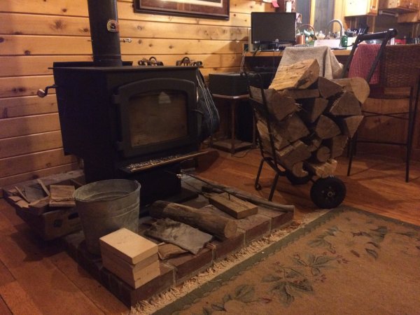

    Got home tonight to the living room at 80 with PLENTY of coals. I threw one bigazz split in at 1030am and I could still tell where it was sitting tonight. I didn't even open the door before I left for the HS choir concert. We'll see where everything is at when I get home around 730. I suspect I'll be burning down coals for the balance of the evening and reloading on a mountain of coals around 10pm. Pics of the wood cart to follow for a split count!
  15. Sam
    Sam
    Nov 5, 2014
    394
    941
    Southern Minnesota
    Hear I sit tonight, a total of that one single big split loaded at about 1030am. Stt of right around 200f and a living room temp of 75. I've been burning these coals down since I first got home at 5pm. I'm attributing a big part of it to the turn in the weather to the better with it sitting right around 19 now with a pretty decent breeze from the south. Supposed to get up to 30 tomorrow. image.jpg

    So! how do you like the stove all together?
    And how do you like the bypass I never had a stove with one
    are you still running your Deka 24 7?
    Horkn and wildwest like this.
  17. Sam
    Sam
    Nov 5, 2014
    394
    941
    Southern Minnesota
    I'm liking the stove a lot HD. The bypass is necessary at least on my setup, otherwise I'd have severe smoke spillage. As it is that's currently my only complaint, I get spillage if I leave the door too far open for too long. I also get a back-puff of smoke (really just the smell) if I close it down all the way too early in the burn. I'm thinking that if I left this stove in the living room that I'd probably want another 2-3' of class A on my chimney to increase the draft just a bit, especially in the warmer weather. It seems like it doesn't pull quite strong enough to keep the secondaries engaged even when everything is well up to temp. If I pull the primary air out just a bit then I can get flames in the firebox again but they don't have the intensity like it does at the very beginning of the secondary burn. I was thinking that with the secondary air unrestricted that it should pull as hard as it wants too based on the draft of the chimney and that's what made the secondaries "work". Does that sound correct or am I over-analyzing the situation?
    I'm still burning the Daka 24/7 just because I haven't figured out a good way to keep the basement comfortable while not roasting the living room occupants. I struggle with the same situation that redneckdan has of moving the warm air. All the cold air readily falls into the basement and the main floor cooks even with the furnace (LP) fan on constantly to circulate it.
