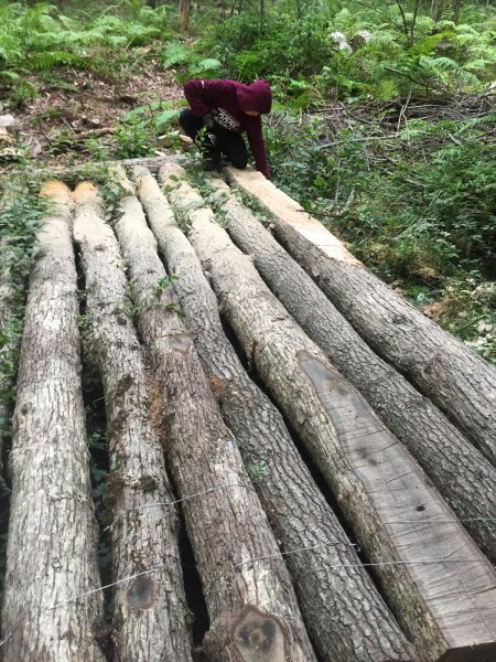

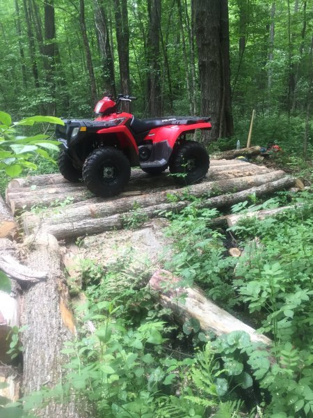

    IMG_6326.JPG IMG_6327.JPG IMG_6327.JPG IMG_6328.JPG IMG_6331.JPG IMG_6333.JPG IMG_6444.JPG IMG_6445.JPG Ninja and I got a little more time on the bridge today.
    Finished lashing timbers together, put the white oak on and off ramps down and took a shake down Cruze.

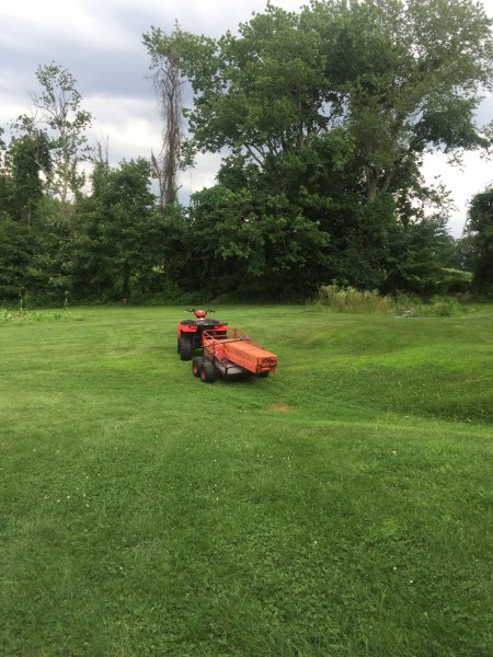

    Progress.
    Timbers now milled. Ninja hauled them into the cellar and stickered them.
    We'll let me set for a while and I'll keep an eye out for some out door stain on CL. If nothing pops up, we'll bite the bullet and get something at the depot.

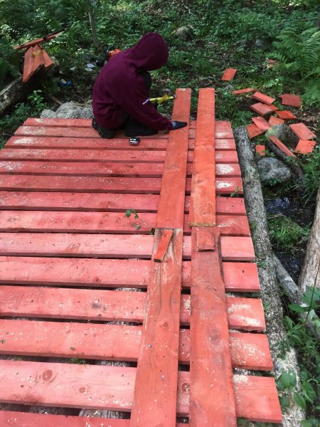

    Loaded up to head out back IMG_6929.JPG shaved the high edge off the west log and relashed it with the stainless wire IMG_6931.JPG set a center plank and worked outward from there IMG_6932.JPG Ninja doing his finest with a right handed hammer IMG_6935.JPG last board off the day. IMG_6936.JPG Rough decked and getting out of Dodge before the squitoes drink more than the sweat in our soaked clothes. IMG_6937.JPG
    Everything is two-nailed at the high spots. Still need to go back and shim the lows and throw a couple more nails in.
    Trim the sides, dress the ramps and lay the wheel strips and we're there.

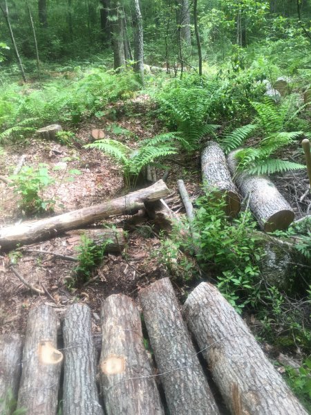

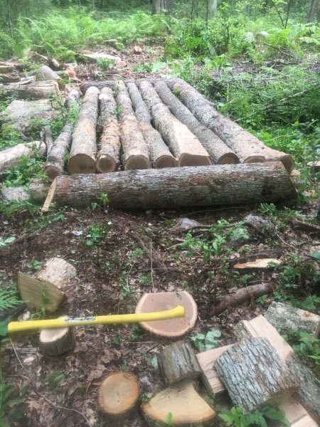

    IMG_6983.JPG IMG_6966.JPG IMG_6967.JPG IMG_6972.JPG IMG_6973.JPG IMG_6982.JPG IMG_6983.JPG Got a couple hour this afternoon to start putting the cherry on top of the cake.
    It was a little cooler, breezier, and nicer working conditions.
    Down to the approach and ramp details.
    We did bring our first load of wood back across from that side of the brook. White oak from the trees that made the bridge.
