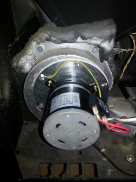

    Did you try running it outside the stove using a temp power hookup (an old lamp cord works great....properly insulated, of course)? Maybe it's out of balance?

    Yep.... those are not oil ports. Do not drop oil in those holes. That motor has sealed bearings.
    You can try to oil them, but do not attempt to do it through those holes.
    The oil will need to be specifically placed on the actual bearing and spun. Via your fingers or a Patch cord (please be careful when using one, if you are not comfortable with doing Elec work? Then do not use the patch cord)

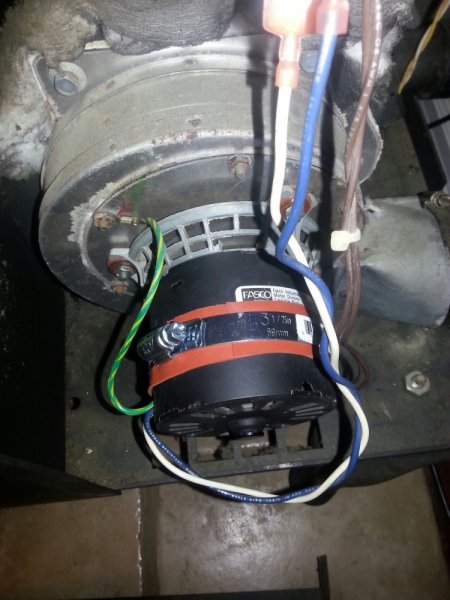

    Hey all, It looks like i will have to order the fan anyway. the vibrations has not let up eventhough I took the thing apart. I ordered the silicone sheet to wrap around the motor using clamps but due to unexpected surgery I havent had a chance to do it. I will try to do it this weekend if i feel better if not i will order the motor soon. Its getting colder out.

    Thanks everyone. I actually feel much better and while my wife, the nurse, stepped out to run some errands I misbehaved and took the thing apart. I used a 1 inch strip of silicone sheet. Boys and Girls it works like a charm. I dont remember this stove being this quiet. I guess the noise got louder incrementally throughout the years and I didnt notice it. Its magic. I guess it was either unbalanced and this did the trick or the rubber holds that motor cover in place and minimizes the vibration. Whatever it is, its working.

    Slvblkk, I saw a YouTube video and thought Id give it a shot. Thus far its quiet as a church mouse and its been running for over 2 hours. Ive been checking the temp on the clamp and rubber and it seems to be pretty constant. Cold to the touch.

    Aaaaand the vibration is back. Looks like i will have to order that fan anyways. It was quiet for a few weeks but now shes barking again. arrrggggg
