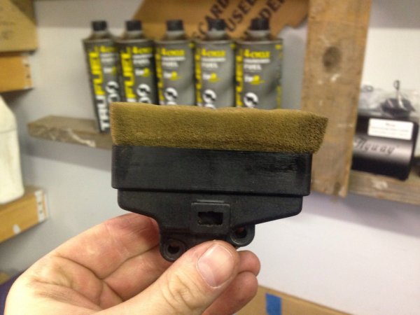

    I can post a pic of the old filter setup later tonight. I don't see them very much, the vast majority of these saws have the new filter setup.

    1st gen 1123 series foam air filter setup.

    Looks familiar! Just think that filter is old enough to drink lol!

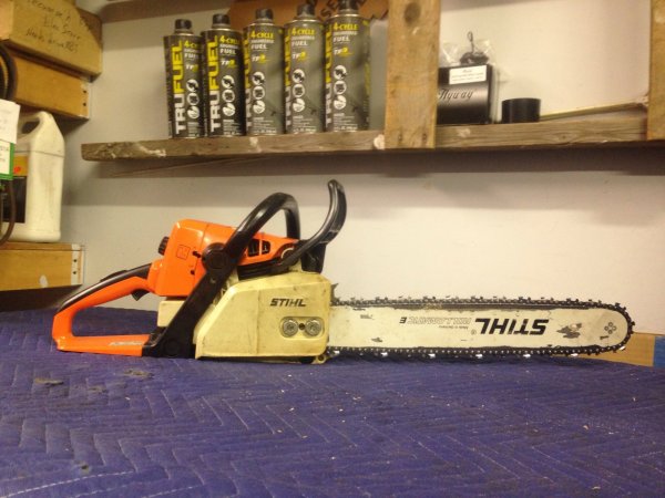

    And here is our finished product. Sorry no vid of this one guys but I can assure you this thing is a runner! Ray, you're gonna fall in love with her all over again.
    I always liked the straight-lines of the early 021/023/025.
    Here's a vid of the last MS250 I did. Same engine, same muffler mod except that Rays saw here has the screen in place and no grinding on the deflector. Look for info on the muffler mod in a separate thread later this evening.
    Rays saw runs every bit as good as that one. :saw::saw::saw:

    Looks awesome Brian! I have always liked that saw.. Thank you! Question, should I give full throttle to start the saw as I have been doing or does it start without pressing the trigger? Not a bad looking saw for one that's 20+ years old :)

    No need to hold the trigger. She starts as advertised now.
