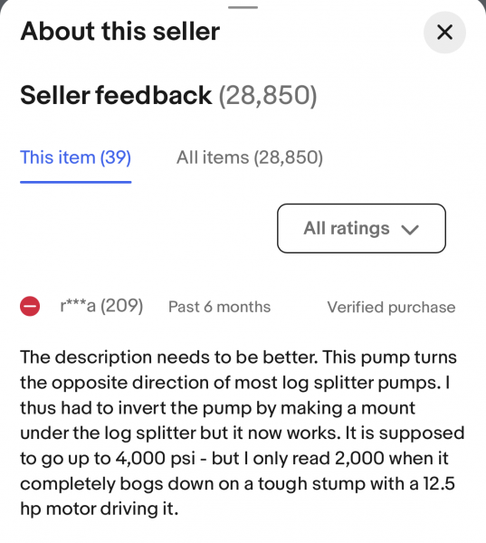

  19. The Wood Wolverine
    18,937
    122,149
    So, I’m planning to go with the fleabay one. Looked at seller feedback and see this;
    :picard:
    Guess I won’t be ordering from work today. Should be able to this weekend. 90 day warranty so I’ll be splitting the rest of my sons hoard soon.
    Chaz and brenndatomu like this.
  20. brenndatomu
    25,288
    164,614
    I'm calling BS on that feedback,,,if it turns backwards then everyone would give it bad reviews, because most all small engines turn the same way...
