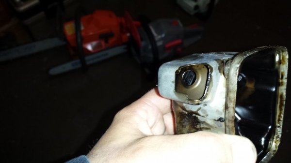

    The only reason to buy another muffler, is to have a stock one, so if the saw ever broke? It wouldn't have a modified muffler when you took it back to the dealer.
    But what you would want to do, is cut out any internal baffle and enlarge the exhaust outlet, or add a second outlet. You can buy a deflector online for about $10 or make your own.
    This is how my MS 362C-M was done. I opened up the stock outlet a fair amount..
    Stock outlet

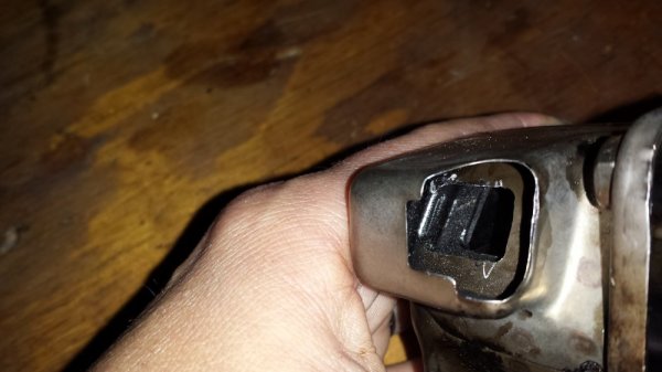

    After opening up Stock outlet

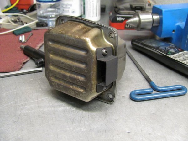

    This is what Randy added when it went to Tennessee to be massaged. :thumbs: This is a "dual port". It's a second port made by drilling a separate hole on the opposite side and adding a deflector.
    All it takes is a Dremel and a decent cutting bit.

    Does randy custom make those doesnt look like a factory cover that I have seen?

    I'm pretty sure that deflector is custom fabricated.
