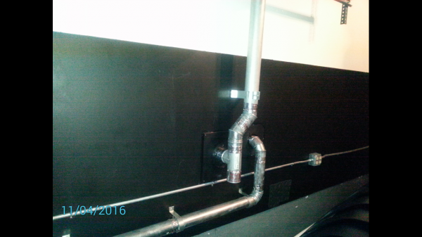

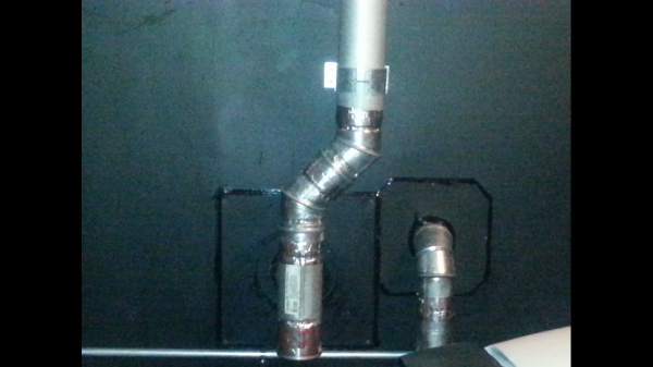

    Anyway its straight out thru the wall into a clean out tee directly into 2 45s straight up after that . I have to take a picture its complicated. But I shifted the vertical pipe about 3 inches right to accommodate the 45s. I have no play left. If I lift the stove an inch the 45s will lift and I cant bend that pipe anymore

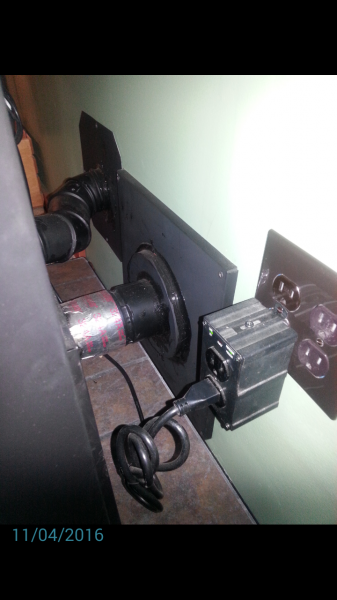

    Heres the photos. This install is thru my exterior wall with an attatched unfinished garage behind it. Exterior walls are sheathed with homosote board so wind sheer braces where used and absolutley needed. My install was directly in the path of a brace. Stove could not be moved anywhere else in the living room due to a deck , windows and roof overnhang. The black and white wall you see is new because of the brace the corner studs had to be notched to accept a 4x8 x 3/4 piece of ply wood for the fact I had to notch into the 6 inch wind brace at least 4inches deep to accept the wall thimble. Pay close attention to the vertical exhaust pipe, it was pre existing thru the roof from my old stove. In order not to have to cut a new hole in the roof and patch the old hole I made it work with some 45s luckily. Notice the height and angle of the vertical pipe compared to where the horizontal pipe exits the thimble. This was an extremely hard angle to hit. Now lets talk stoves and options in my next post

    As said earlier an accentra is the only stove that will just slide in and match up with the exisiting pipe, but accentra is not my style and I dont want it.
    Xxv.... I love this stove almost as much as the advance, the xxv collector sits at 8inches plus. The problem is that wall thimble is sitting in the notched out wind sheer brace(try and picture that thru the wall) the thimble cannot be moved up because of the brace above it, the brace even with other measures taken in the corner of the walls cannot be removed per my engineer I hired and the town inspector as they where worked with closly on this install. Third if moved up and inch the 45s would also be moved up which would have to make the vertical pipe swing right some more to accept. The pipe cant be bent anymore to much stress on the joint as it is. Luckily no leaks at that joint
    P series. Ok stove but I dont want to settle. But if I went with p series the collector sits around 5 inches which means the dealer has.to provide a raised hearth pad which I imagine they wont. The wall thimble cannot be dropped down any to accept the collector at 5 inches, look at picture one and how I had to notch the floor trim to accept the wall.thimble! You have About an inch of room in the wall before the wall thimble hits the 2x6 floor plate studs. Not hhappening. This is why I am so angry with harman

    I assume going up and then out is not an option?

    If harman wants to supply the pipe and pay my roofers sure..
