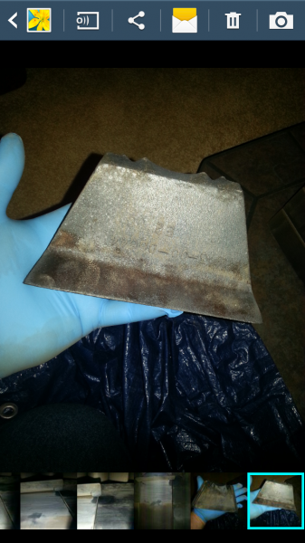

  16. Charles Ingalls
    Charles Ingalls
    Aug 9, 2015
    575
    2,251
    Sleepy Hollow, MN
    Heres the plate

    9,040
    I would need to see a pic of the flame guide/brick panel to tell you.
  18. Lousyweather
    Lousyweather
    Dec 23, 2013
    2,798
    9,040
    that does look kinda odd, actually, although the number is correct

    I have sent these pics to my dealer to send too harman. Ill keep you guys posted on the outcome.

    Harman will tell the dealer to simply go out and fix it......he ought to bring another flame guide too.....what I was wondering though, is that, are you making sure the top of the brick panel is in its retainer at the top right and left of the brick panel? Possibly if it sets too low on the flame guide, it might lose contact above and rattle.
    The dealer will also likely bend that stud....I would.
