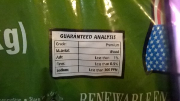

  19. pell it
    pell it
    Jan 18, 2014
    124
    392
    Rhode Island
    Nations Choice---NOT
    surprisingly low ash levels, but not surprisingly low heat levels as well.
    IHATEPROPANE and jtakeman like this.
