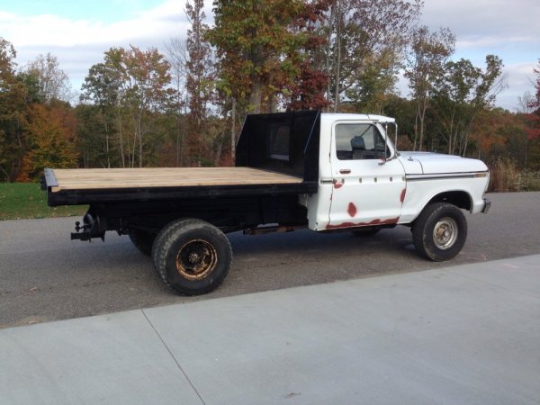

    Painting is a lot more work then it looks like. I was hoping to paint yesterday so today I could easily get the floor and sides done but a malfunctioning had other plans. Oh well work continues.

    Bed painted, floor on. Took it up the road to a friends house and it's spitting antifreeze. I'm going to pull the thermostat and let it run with no restriction for now.

  19. HDRock
    17,268
    60,522
    Bed is lookin awesome , you made good progress
