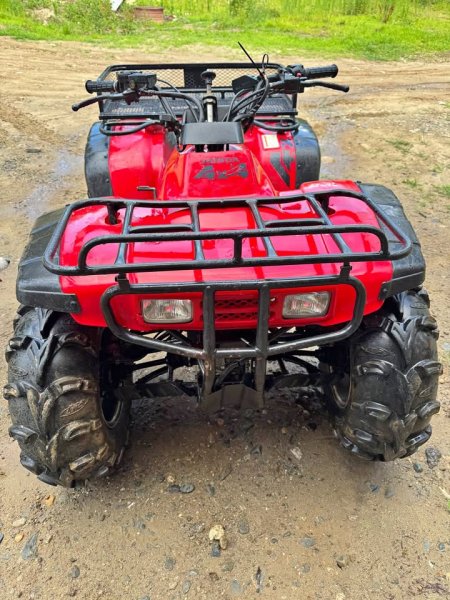

    Looked at a Polaris 700 last night. I know, I know why look at another Polaris? Well it’s older so hopefully the computer is dumber and it was close by. Plus half the sellers on FB never message you back. Anyway the front end seemed to be hard locked in 4 wd. Two spins around the front yard and it felt like steering a rhinoceros with arthritis. Nope.
    This morning I looked at an old Honda, 1999 fourtraxx 300. Told the guy I’ll buy it. It’s old, relatively cheap and starts better than a Polaris off the showroom floor. It’ll make a good back up for my Polaris.

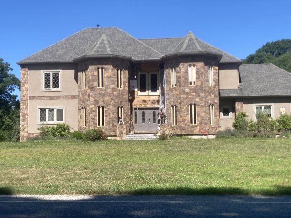

    while I was out in Voluntown Ct looking at the ATV I drove past this house. Anyone remember the show “Extreme Home Makeover”? I worked on this project. Build a house in 7 days or whatever it was. Part of the crew that did the stonework. Fake stone as I call it, stickystone. Was 5 degrees when we got off the bus that brings you in. The wrong time of year for this project LOL
    Originally in the center there was a crenellated parapet that went straight up for a Castle effect. I knew that would be trouble, ice dams and snow behind it that wouldn’t melt till August.
    They ditched the parapet (good) reworked the roof and it looks like they had a major water problem which I expected. I’m a little surprised any of those stones are still sticking. We plasticed it in and heated but tv,,,,,as soon as the last stone is laid ya gotta pull the plastic for the tv cameras.
    Anyway just thought I’d share. Was a tragic story that family went through.

    Is that a pic of the one you bought?
    If so it has the Warn 424 kit on it, no?!
    You stinkin scored if so!
    That was the only downside to those 300 (full time) 4x4s IMO...almost bulletproof machines! (Especially if taken care of at all)

    I always said I'd never want one of the houses they built...lots of corners cut to do it that fast!

    That’s the one. The Warn 424 kit? Is that the gizmo that makes it a full lock front differential instead of the factory 3 wheel drive? Saw that mentioned as an aftermarket add on when I was perusing the internet.
    A rather young guy selling it. Said he’s been driving it since he was a kid. He’s a diesel mechanic now so hopefully he’s taken somewhat good care of it.
    I’m assuming you’re speaking of that oddball plunger style handle in the center of the bars as a Warn 424? The guy told me it was for shifting into 2wd or 4 wd. He said he installed himself but it must have been long long ago. Also said it doesn’t work right, that it’s in 4wd right now and if you shift it into 2wd it drives funny,,,,harder to steer. Said maybe out of adjustment but never played with it trying to get it better.
    That would make sense if it’s actually locking the differential as I read about, not switching it into 2 wd which I haven’t heard of yet.
    I know at least the left front tire is engaging, I called that good enough, 3 or 4 wd is good enough for a beater.
    Oh yeah lots of corners must be cut to build a house that fast. It is free tho. I wonder if there’s a contract where they have to hang on to them for a set time.
    Edit. Searched for the 424. It is a 2wd to 4wd conversion. I’ll have to play with that a bit and see what happens.

    Yes.
    Hmm...that doesn't make much sense, all the Warn kit did is replace the 1 piece front driveshaft with one that can be "engaged/disengaged" as far as driving the front differential...as I recall it was a simple splined shaft deal.
    The one I put the Warn kit on was much easier to steer at low speeds (like tooling around the yard, or tight woods trails, but this was also probably 20 years ago, so my forgetter might be kicking in again...it was a customers bike, so I only rode it for a few minutes to check function after installing it. He seemed to really like it anyways)
    Suppose the previous owner still has the original driveshaft? Might be worth having, just because...

    So the warn kit allowed rear wheel drive because the 300s were full time 4x4?

    Yes, doesn’t make sense unless it’s in 2wd now which is what the knob is showing. I wonder if he left the spring out. A common mistake I hear. You need to remove the internal spring from the original driveshaft and install it in the new one.

    I do recall there being a spring...forgot that it was the OEM spring that got reused.
    Yes.
    Front diff was not altered, just the driveshaft was changed. Pretty slick deal really.

    That was a welcome addition to a full time, no center diff unit I'm sure.
