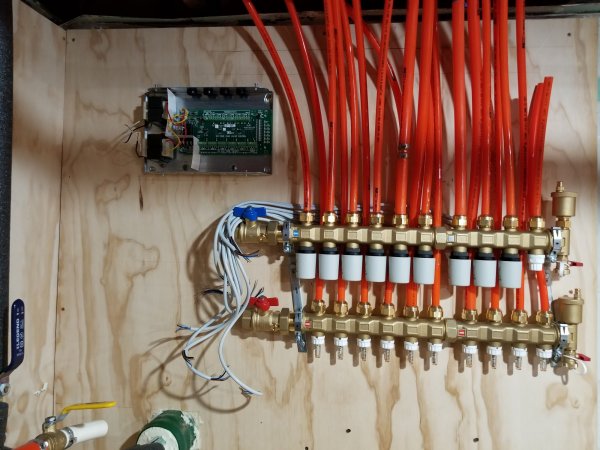

  10. lukem
    12,274
    66,602
    Got a start on the new plumbing tonight. Wiring is next. 20190209_215146.jpg

  11. Chvymn99
    21,479
    113,743
    We mold those electrical boxes, along with a few more Grundfos stuff... :handshake: ...
    brenndatomu likes this.
  12. lukem
    12,274
    66,602
    Nice. Hope they work good. They appear to be high quality.

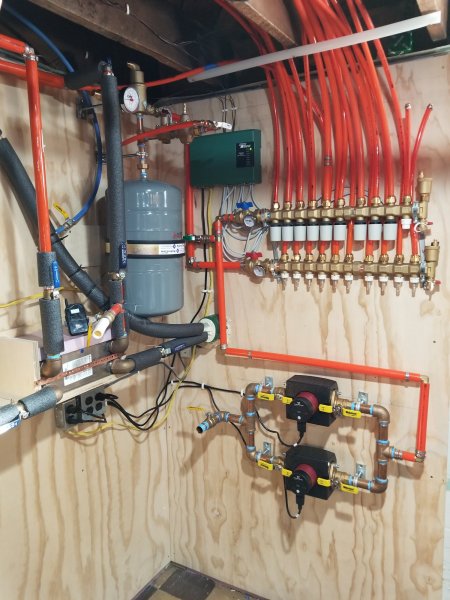

  14. lukem
    12,274
    66,602
    Got my pumps mounted. Not a whole lot else I can do until I'm ready to make the leap and abandon all the old piping, make new connections to the radiators, and plumb into the heat exchanger. Not sure when that's going to be.

  20. lukem
    12,274
    66,602
    New single zone switching relay to energize the propane boiler (and right now the main circulating pump) is installed. Currently I have 3 thermostats active (basement, mud room, everything else) that will turn on the circulating pump and deliver heat everywhere. While this isn't ideal, it doesn't allow any part of the house to get too cold, which was a problem during more mild weather. It also proves that my controls design is working.
